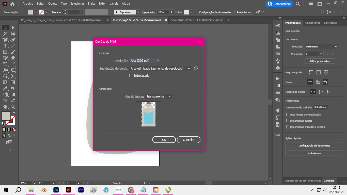

Priscila Weilemann
September 5, 2023
Thanks a lot Ton, I'm attaching the PNG. And also export settings.
