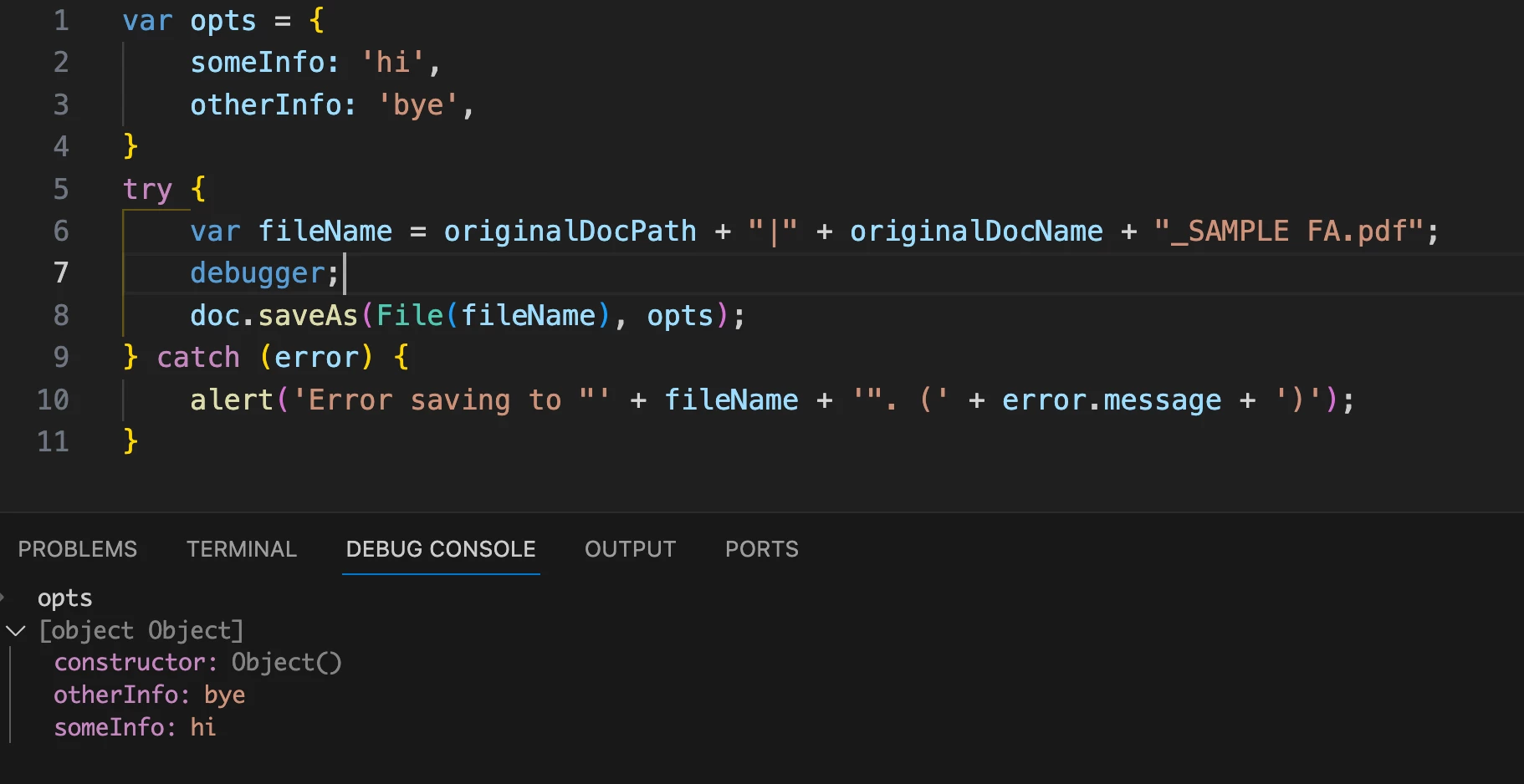

Like Carlos, I suspect it is a bad path. However, I have used pipe characters on MacOS plenty of times and I don't think that is the problem. Pipe characters must be escaped or quoted on the command line, but many characters are like that. On MacOS, I believe colons are the main character to avoid. Anyway, take a screenshot of the error alert that shows the path and that way you can test that path independent of your script. An alternative issue could be the contents of `opts` which we don't know. If you use VSCode with the ExtendScript Debugger, you can put a debugger call right before the saveAs:
var fileName = originalDocPath + "|" + originalDocName + "_SAMPLE FA.pdf";
debugger;
doc.saveAs(File(fileName), opts);
 and then, in your Debug console you can type `opts` to see its contents:
Hope that helps as a start.

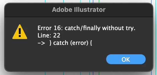

Tried that, unless i placed it wrong, error attached. Thanks for trying buddy.
CarlosCanto
January 2, 2024
On Windows, the Pipe Character "|" is not allowed in a file name, that might be the case on M2 as well.
