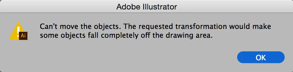

Error: Can't move the objects. The requested transformation would make some objects fall completely off the drawing area.
I just updated to illustrator 2017, and now I'm having problems.
1. Drew line illustration with pen tool. Select All. Hit upward arrow. Get error message that says: "Can't move the objects. The requested transformation would make some objects fall completely off the drawing area."
2. Select All.. zoom all the way out to check the whole gray area for stray anchor points. Nothing showing.
3. Forum says to Clear Guides. I check and Clear Guides is grayed out.
4. I check to make sure no anchor points are on the edge of the artboard, though I can't imagine that would cause an issue. I move all anchor points inward. Still get error.
5. Select All and try to paste on new artboard in new window. Still get same error.

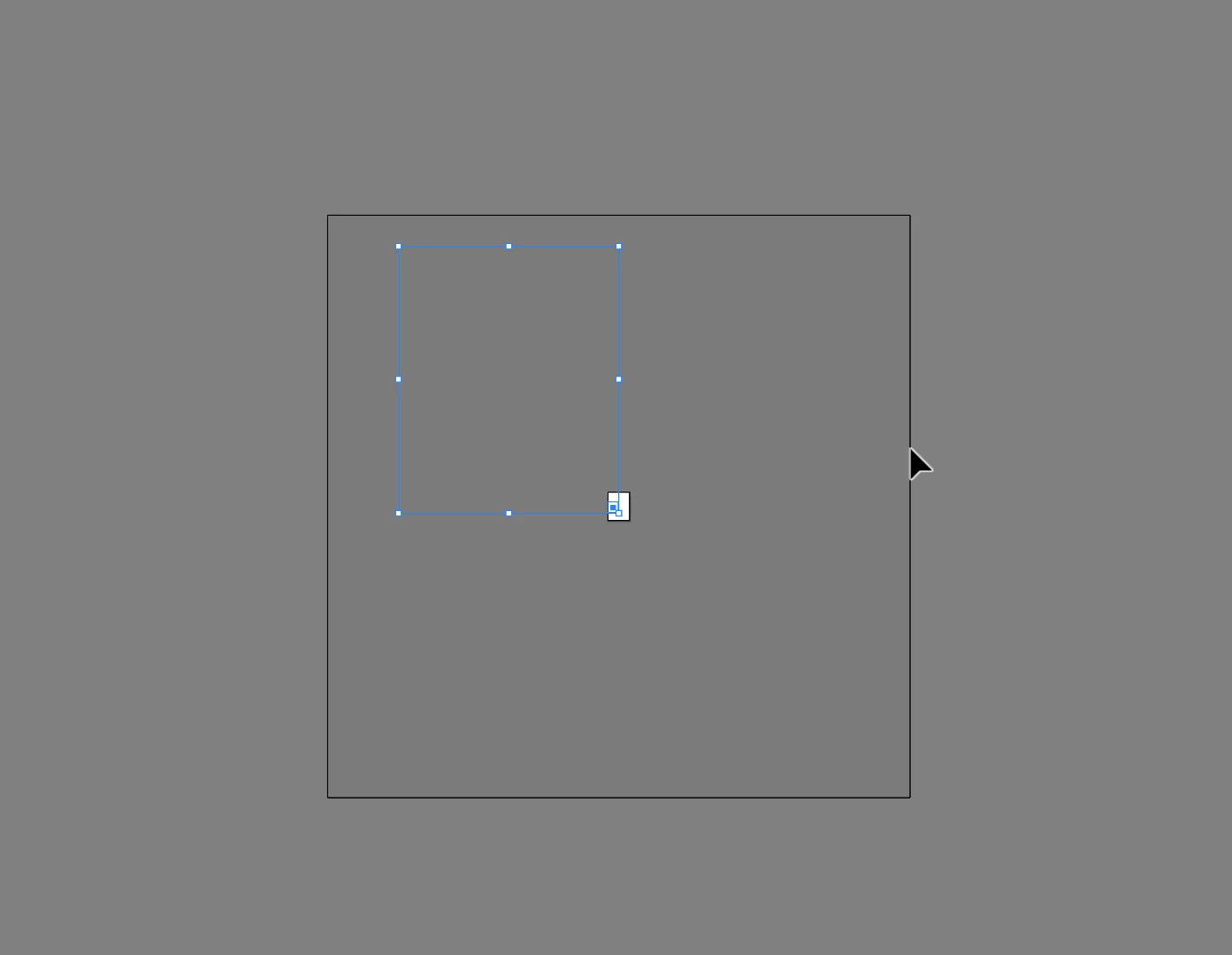

Zoom way out so you can see the drawing area and then Select All
In this example, the white area is a letter-size artboard. In the upper left of the drawing area, a small pen point got selected. If I am only looking at my document and not the drawing area, I will  get the same alert when I move my artwork.
