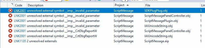

[...] The errors you are getting are for missing debug symbols, which you would only normally get with a debug build.
Agreed, but looks like my case is not 'normal'. I set everything to Release, and still this happens. The other non-debug setting (Multi-threaded) leads to even more compile errors in a Release build.
Ah I found it. FINALLY :-)
In the Preprocessor settings, there was still the _DEBUG definition set - for release builds! So this was really a problem coming directly form Adobe. I hope they fix that soon! LeoTaro​ are you working for Adobe, or would you know who to contact so they update the API examples?

We found out this:  ScriptMessage.aip imports functions from msvcp140d.dll, vcruntime140d.dll, ucrtbased.dll, vcruntime140.dll. It is part of Microsoft Visual C++ 2017 Redistributable.
So this made me think that the problem is using VisualStudio 2017. So I installed VS2015 and compiled an original (untouched) example from Adobe with that (using Release x64 configuration). But the problem persists.
Jul 4, 2018 7:10 PM UTC
If you use VS2015 instead, the plugin will just try to load different versions of the runtime dlls and if they are not on the test machine either you will get the same problem. Try building with the static versions of the runtime libraries:

Jul 8, 2018 3:05 PM UTC
Thanks for your answer. The runtime library was set to 'Multi-threaded Debug Dll' which I changed to non-debug. But then I get build errors :-(
