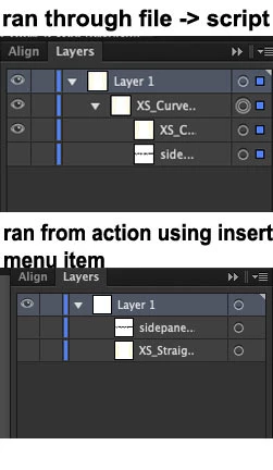

This script runs perfectly when I run it from File->Scripts but the second I put it into an action it doesn’t work properly. I’ve narrowed it down the the select sections that appear to be messing up.
I’ve tried the select a few different ways to try and get it to work with the action, but the multiple ways don’t seem to be working.

I’ve tried multiple different ways to select and complete this but none seem to have worked when running the script from an action. But they work perfect just running the script by itself.

    Here is how I have the action setup. just a menu item.
