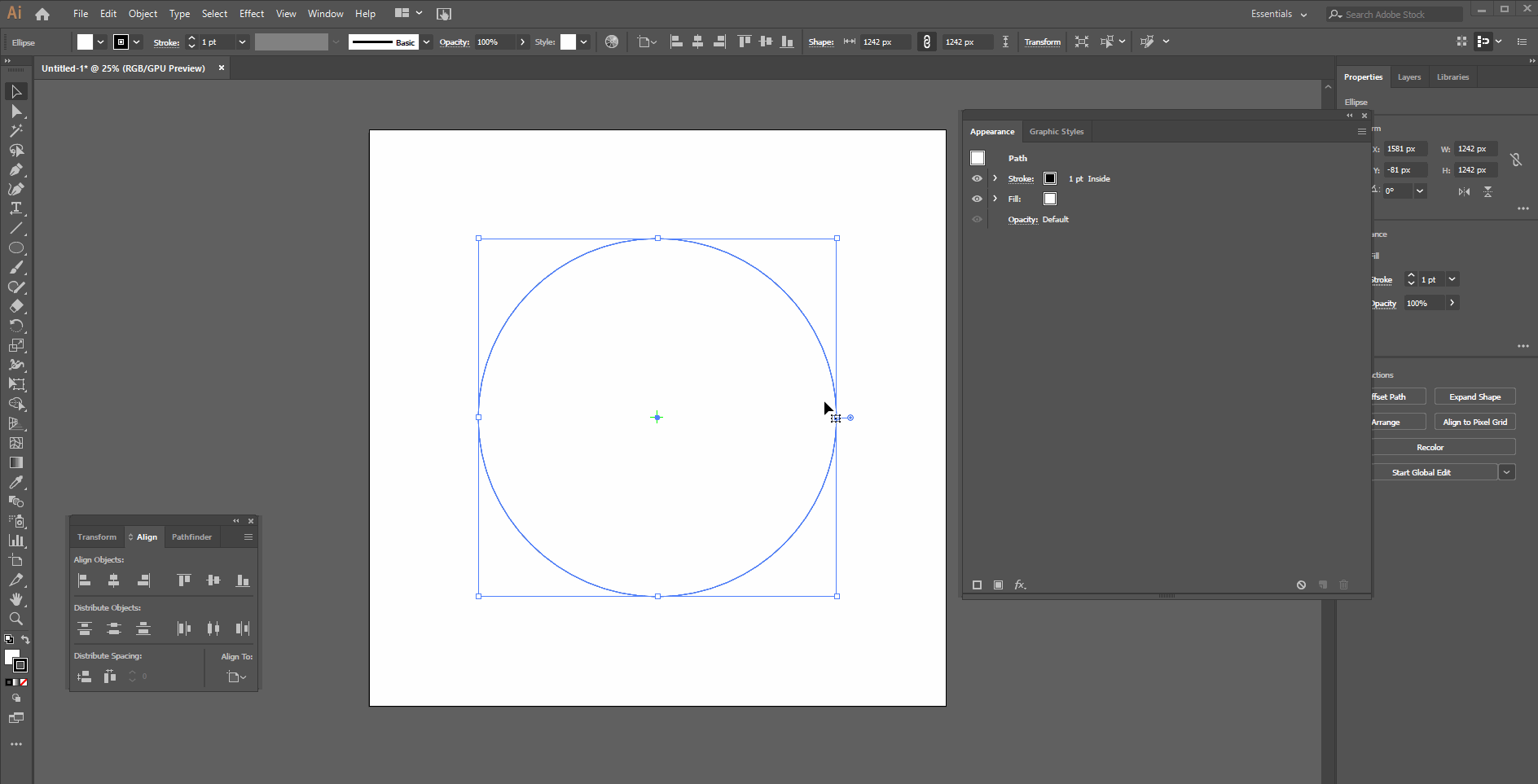

I am following a tutorial. One of the steps is to expand appearance. However this option is greyed out and I do not know why. I am following to a "T" and I cannot access expand appearance. help!!

Hi Pat,
Thanks for reaching out. I would request if you can try these steps:
  • Create a Circle
  • Select the Circle and click on Shape on top
  • Change the Pie End Angle to 45
  • Without touching anything on the Artboard or screen, go to Edit >  Expand experience. Take a look at this GIF.
For more details you can also take a look at this help article: https://helpx.adobe.com/in/illustrator/using/grouping-expanding-objects.html
Let us know if that helps or if you have any further query.
Srishti

Expand appearance is only active when there is an appearance (an effect, a brush or anything else which is special). There probably is none, so you might want to tell us what exactly you have and what you want to achieve.
patd61312907
September 18, 2019
Thank you. I drew a circle, colored it orange, then created a 45º pie shape. From there I wanted to expand the appearance before adding an offset path. This is where expand appearance was greyed out.
Monika Gause
September 18, 2019
And you created the pie shape how? By using the shape widgets? So far there is nothing you need to expand.
