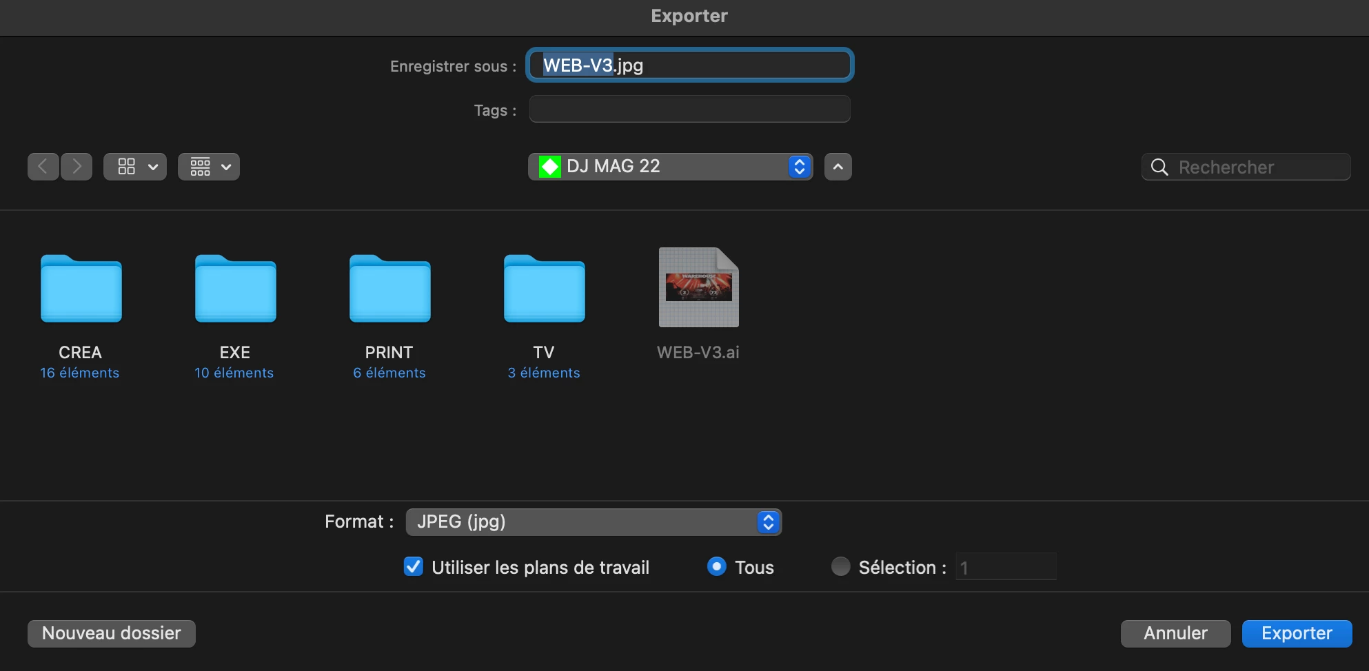

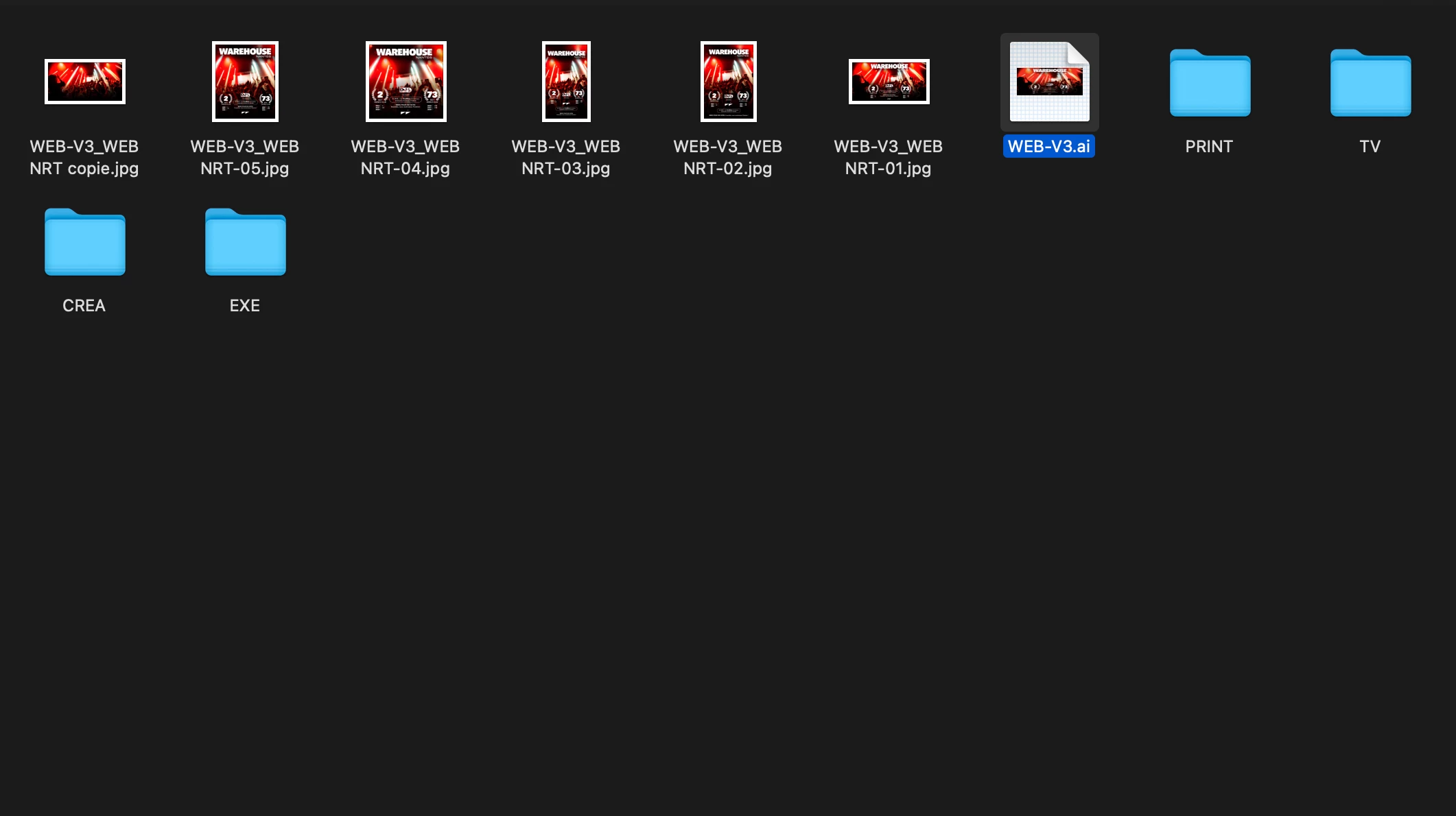

Mes fichiers change de nom qd je fais un export jpeg. je dois renommer mes fichiers et je perds un temps fou. Avez vous une astuce pour cette anomalie?

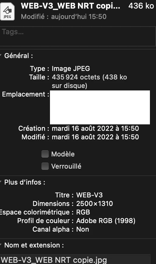

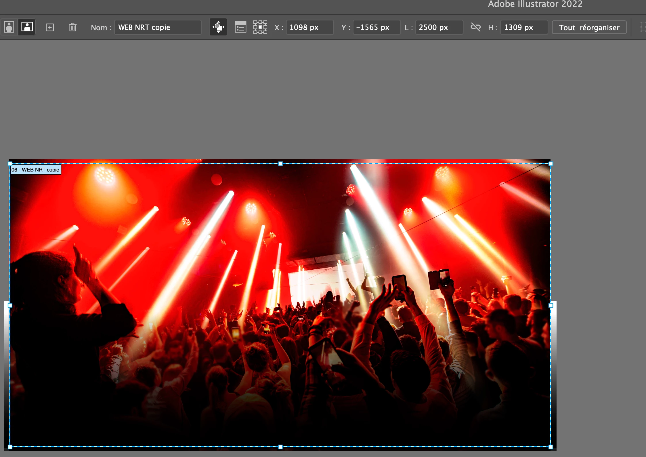

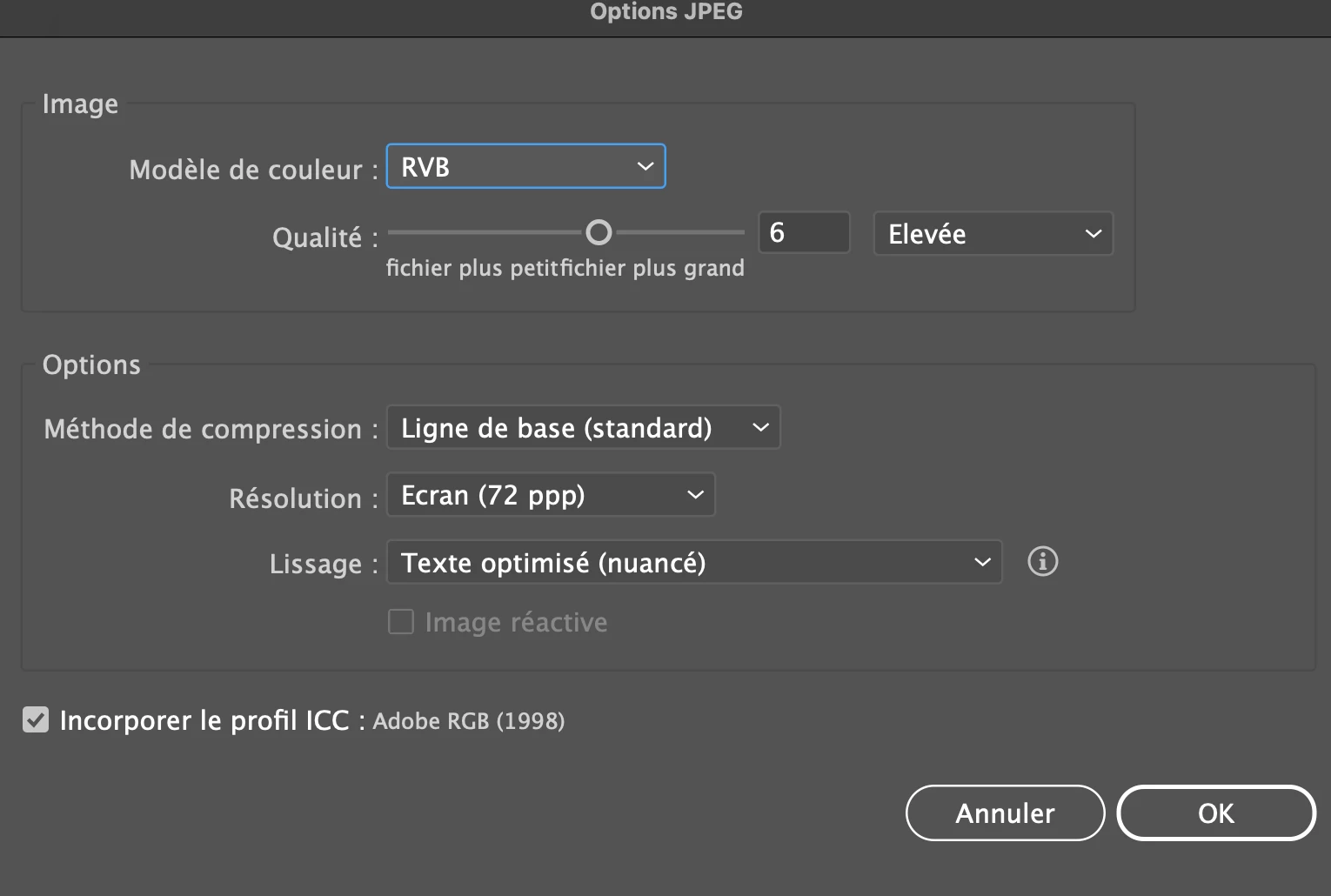

Here is the screenshots
Also my image is 1 pixel bigger in large than the original!

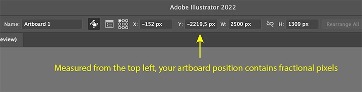

Your image is larger because the artboard does not align to the pixel grid. The upper left X/Y coordinates should be round numbers and not contain fractions.
You can fix that for all of your artboards by clicking Rearrange artboards.
