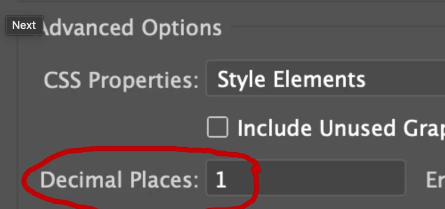

Hi! I've messaged on several forums before elsewhere hoping someone has a work around for this but haven't had any luck. Here is the problem I have:
1. Design a file in Illustrator, save it as an SVG and then open it in my laser cutting software (Lightburn). and the size is different.
2. I've checked off responsiveness so that's not the problem.
3. I've purchased SVG files from other places and can open their files in both Lightburn and Illustrator and the file object size is the same.
4. I know it's not off by a lot but I need it to be the exact same size as these files I'm creating will be for selling.
5. I've also designed it in my lightburn program FIRST, exported it to Illustrator and the size still changes.
I'd appreciate any help at all as to what I'm doing wrong before I scratch my eyeballs out - I've been at this for over two weeks trying to find a solution.
The Lightburn program has import settings at 72 DPI and the settings I usually have for Illustrator are 72 PPI.

You have your svg export decimal place set to 1. Change to 3 or 4.
