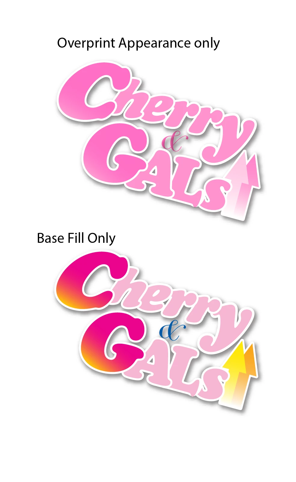

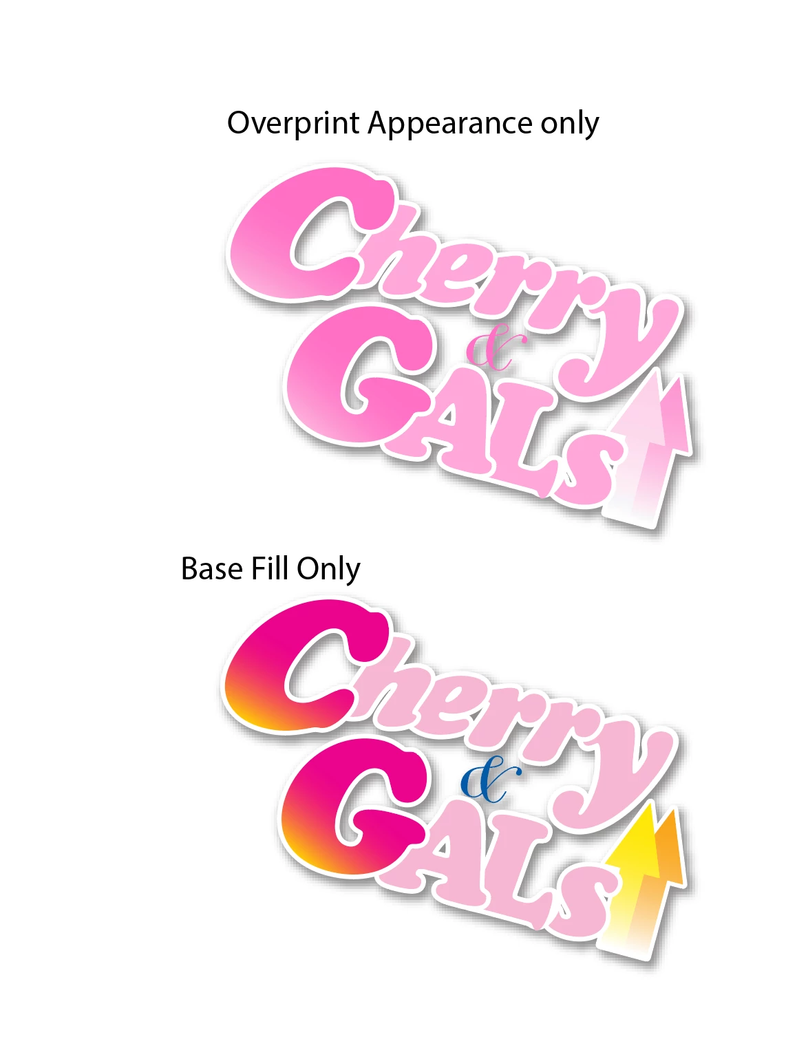

    I am also working on this file. Here is a side by side screenshot of an area where it is most affected.

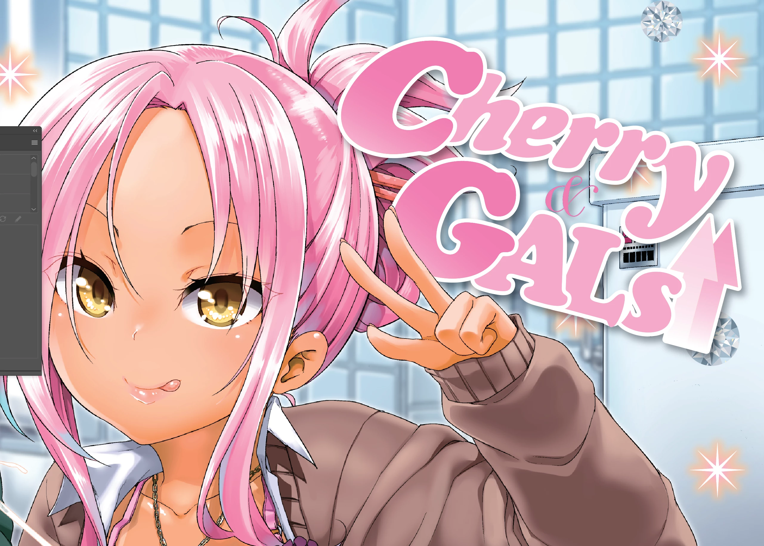

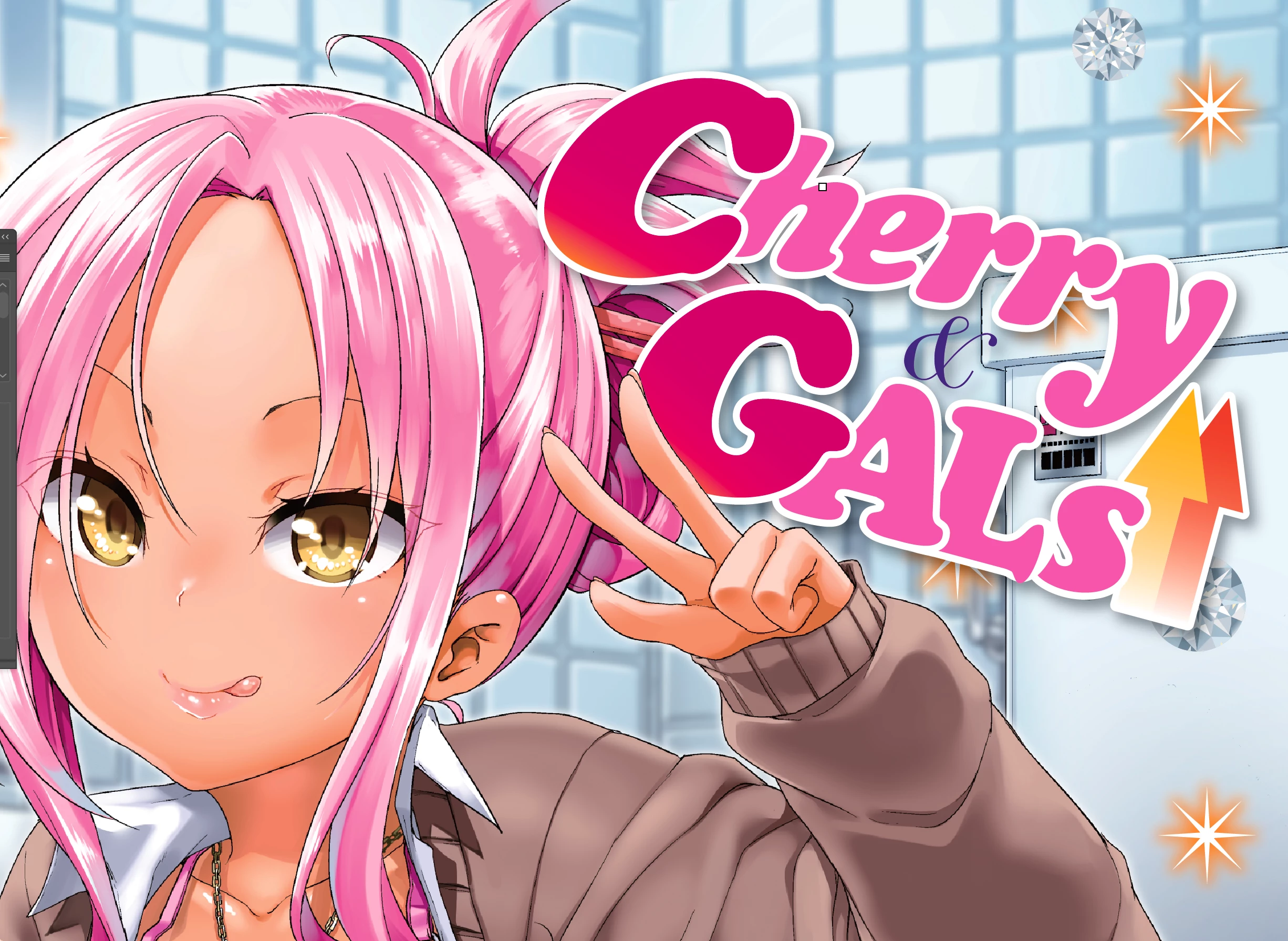

    Here is a screenshot of the cover when the overprint view option is turned off. This is how it appears when it is exported. in any format.
    Here it is with the overprint view option turned on. As you can see, it is a completely different color and the brightness of the pink is affected.

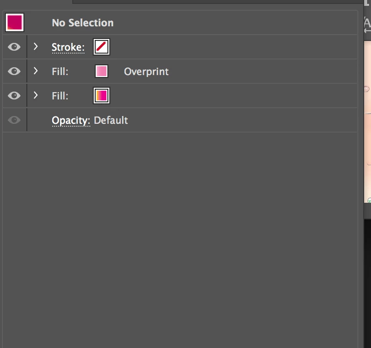

    Here is a view of the appearance panel. We attempted to create an overlay effect by using just the overprint pink color on one image, and the base fill on another. When overlaid it still doesn't look right.
    Here are the differences in the pink color of the overprint fill when the overprint view is on Vs. off:

    We need an export of how the file looks with the overprint turned on. Simulating overprint as a post script file and as a simulated overprint in Indesign doesn't work.
