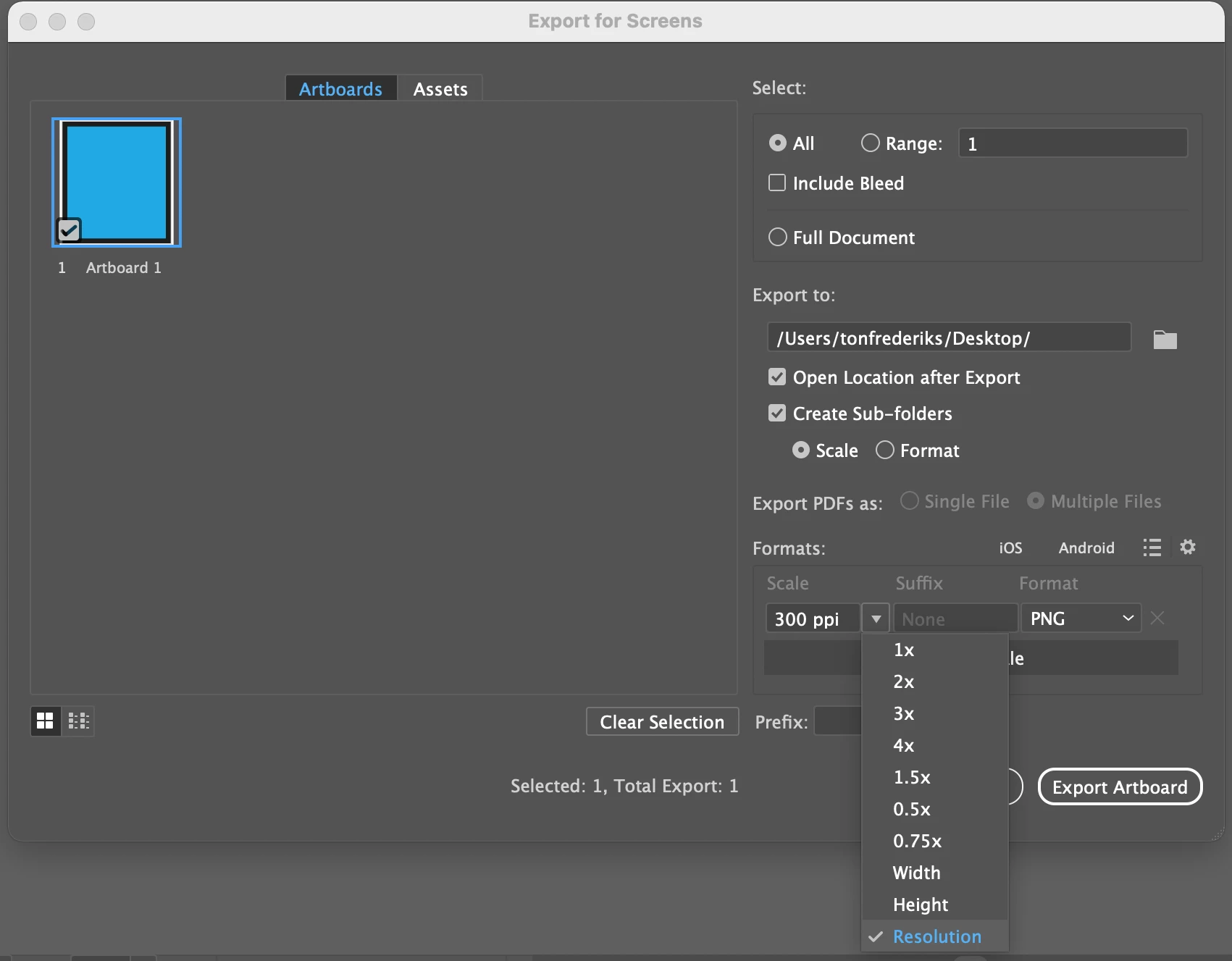

You can export the artboard using Export for screens and set the Scale > Resolution to 300 ppi.

Thanks Tom - the 300 looks great but its coming out large. the 1x looks like correct size but only 120k.
Do I have the settings messed?
Ton Frederiks
February 6, 2024
If I do it this way, it comes out at the correct size and resolution.
