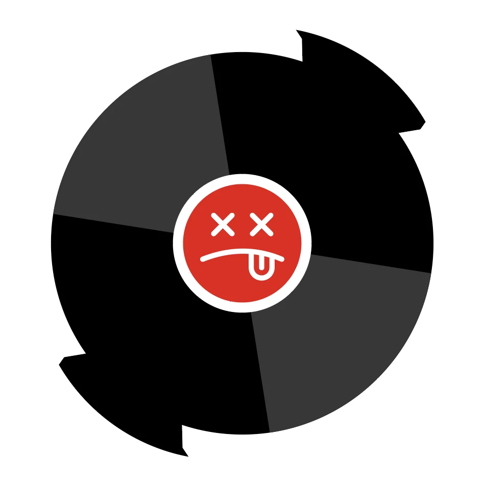

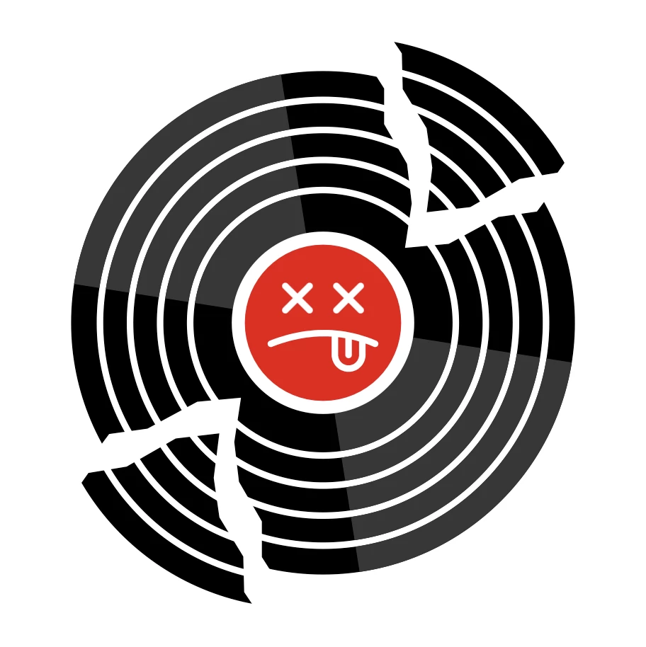

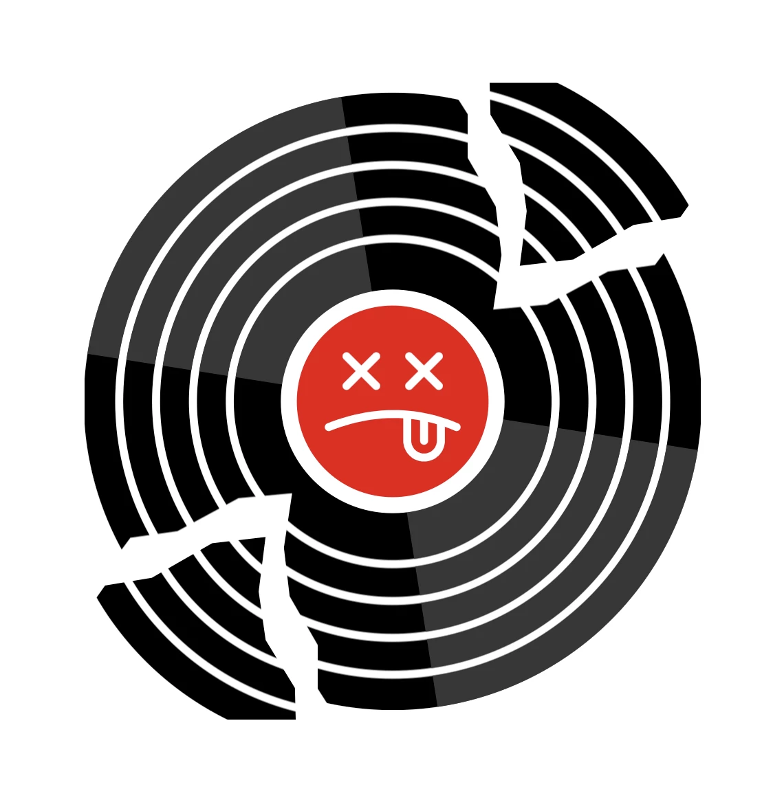

Hi there,
Not sure why this is happening. When exporting this vector artwork to SVG it is clipping it's edges, the top and bottom are more obvious, but with careful inspection you can see the left and right sides are getting clipped off too. Anyone know whats going on?
Attached images for clarification. These are just two screenshots, one is from the .ai file so you can see the full artwork, and the other is of the SVG so you can see the clipping occuring.
Thank you!

May 17, 2025
Here in 2025 running into this problem. It seems like the export option sets the artboard to fit the artwork, but in my case I have a drop shadow offset past those edges.
My work around was to add a rectangle snapped on the corners of the art board, with no fill or stroke, so just an invisible path. Then I exported it as SVG, and all is well.

September 29, 2022
All your paths have odd offsets. It's like you tried to manually build a drop shadow with duplicate paths. The content is only visible where the bounding boxes of the outermost paths intersect and that's why stuff gets clipped. You also have a view box much larger than you actual content and fractional pixel values. All of this leads me to believe that you need to fix your document setup. Check the unit settings and document DPI, crop the artboard to the content and try again.

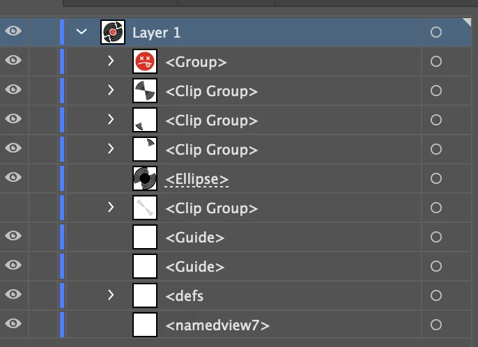

September 27, 2022
It would be useful to have the actual SVG file/ SVG code. This looks like the box is simply calculated wrongly. At the very least I would delete the invisible layers before exporting. This has been known to throw off things occasionally since AI wrongly considers this data.
Mylenium
ostettd
ostettdAuthor
September 28, 2022
I have deleted some weird things in the layers panel that I didn't know, and same issue. Attached is a new screenshot of the layers panel, and the new SVG file itself. Alternativly, the text below is the code (right click SVG file and open with text edit)

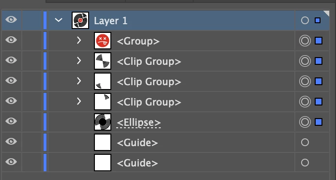

September 25, 2022
What's in the file? Are those just simple paths?
How is the file structured in the Layers panel?
Which options are you using when exporting the SVG?
Which app are you using to view the SVG?
ostettd
ostettdAuthor

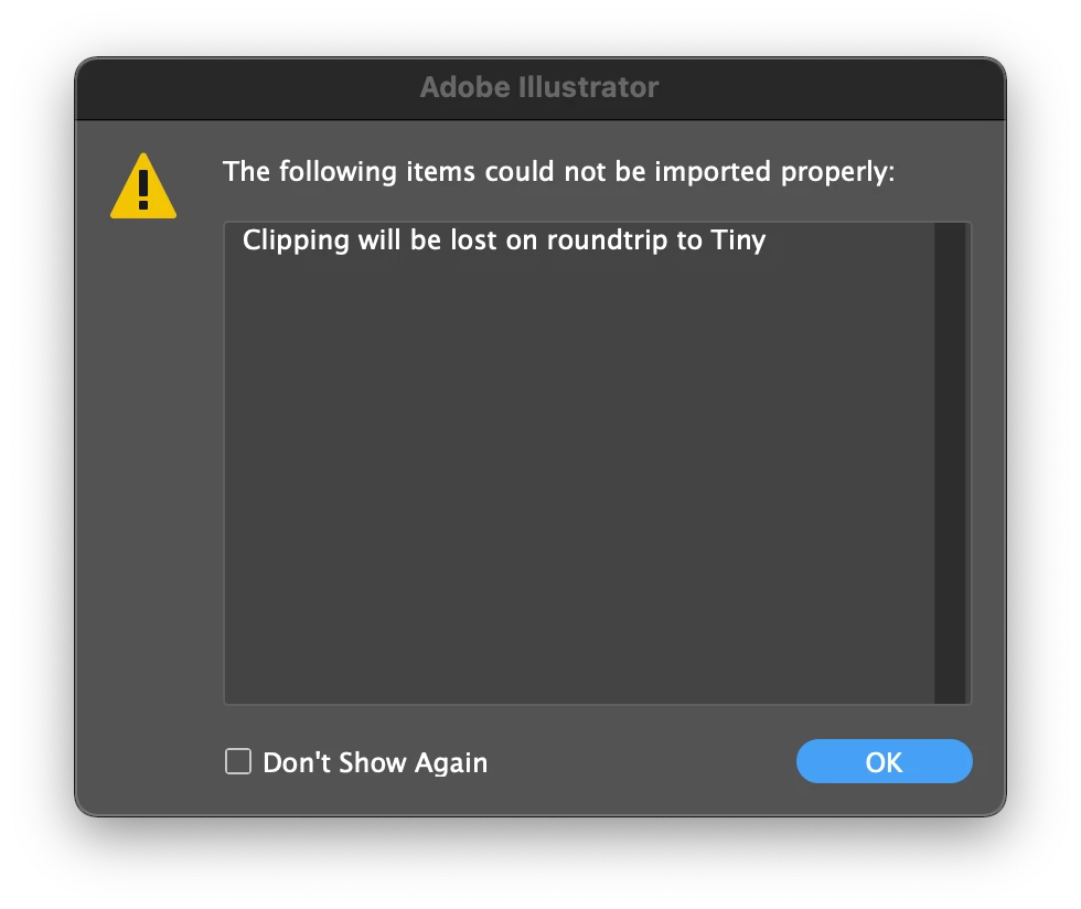

September 26, 2022
Yes they are just simple paths, there are some clipping masks though (the shine effect, and the "broken" parts of the record are the full record, but with the clipping mask hiding the majority of it).
Everything is on 1 layer (screenshot attached)
RE: SVG export options: Screenshot attached
I'm using preview on the mac, but when uploading the file to Wix for my website, it still clips just like the preview shows. Interestingly, when I import the SVG back into illustrator i get an error msg, and the record looks wildy different, but the clipping isnt occuring (screenshots attached)
