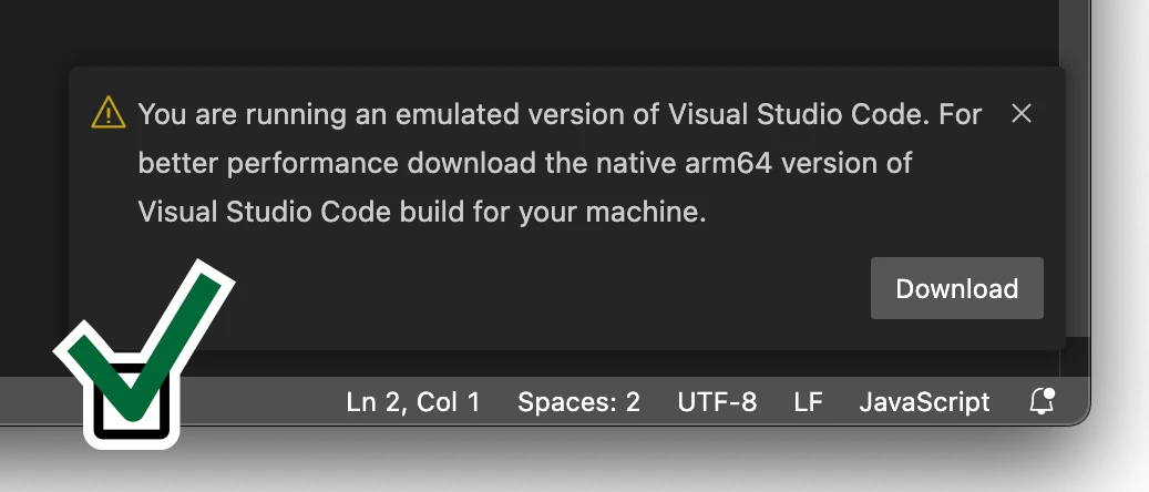

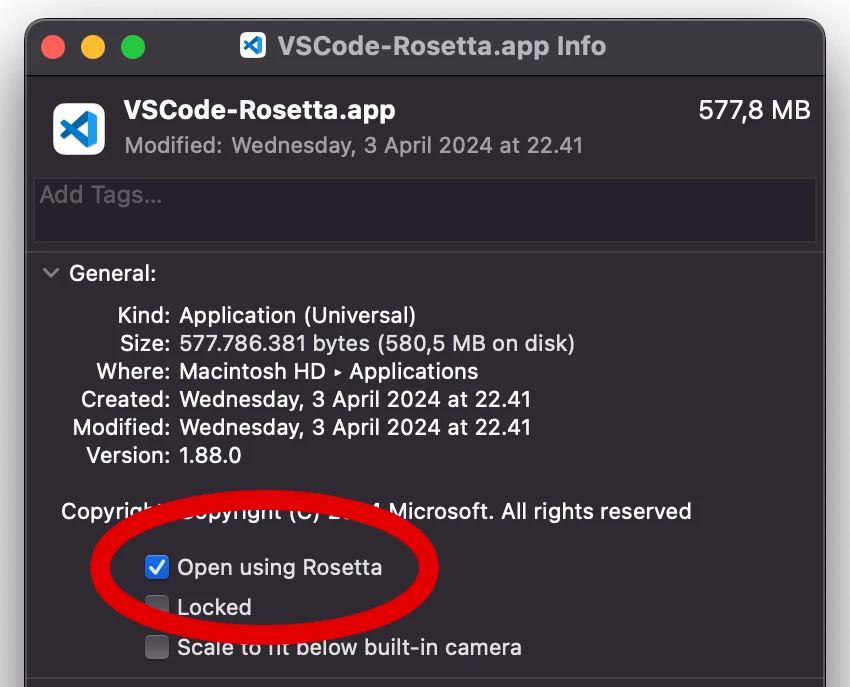

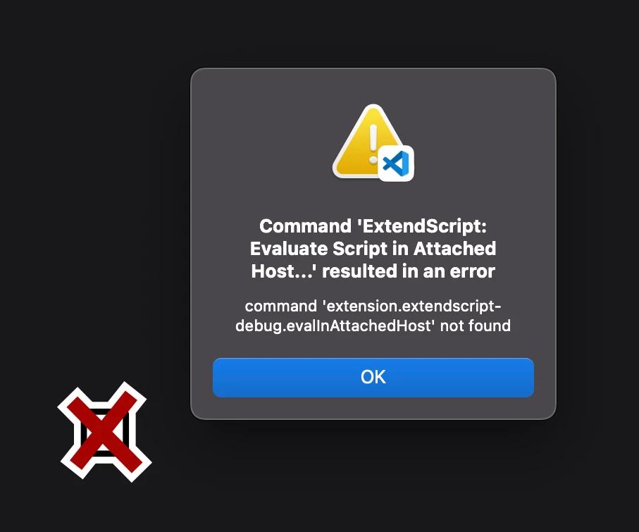

I've been drawn to this post multiple times, when I get that error. I am leaving this message to future me, and any other Mac users with the same problem:
Re-check if VSCode / Visual Studio Code has been opened with Rosetta.
I don't know why, and how, but my MacOS sometimes uncheck the box. Which leads me to the error. Rule of thumb: If you're not greeted with doom and gloom from Microsoft, you're not ready to interact with Adobe.
quote
Command 'ExtendScript: Evaluate Script in Attached Host...' resulted in an error
command 'extension.extendscript-debug.evalInAttachedHost' not found

Hi @Razamus, I had this problem too. There was a bug in VSCode that caused it to run in ARM mode whenever it had restarted after an update (which was fairly frequent).
I solved it be reinstalling the Intel-specific build of VSCode (not universal). In this case there is no way it can switch to the ARM binaries. You can choose this option at the VSCode download page.
(By the way, I also run a copy of ARM-only "VSCode Insiders". I use this for non-ExtendScript stuff. I choose insiders because it has its own bundle id which means we can pair different file types to launch whichever version you like—which you can't do if you have multiple copies of plain VSCode installed).
