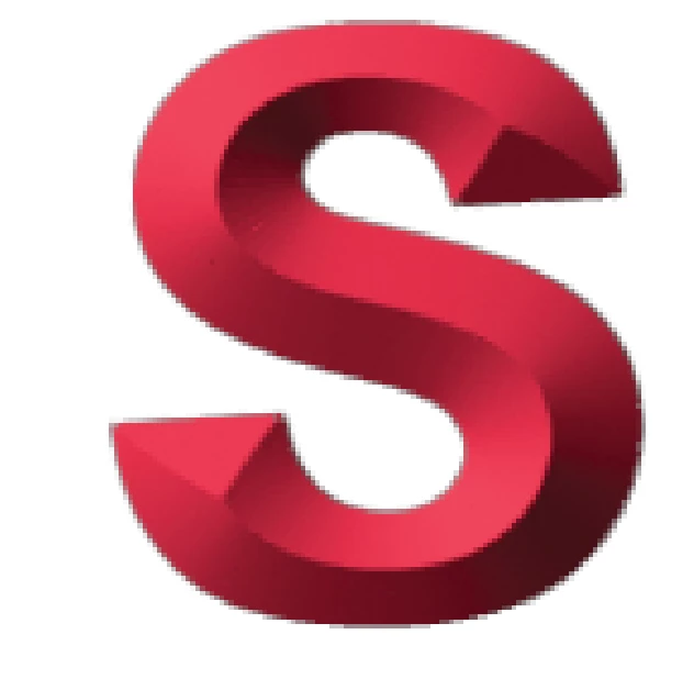

When I apply the 3D and materials with the extrude and bevel to my logo the edges are pixelated. How do I smooth out the edges?

These effects are raster effects, so if you're expecting them to stay a crisp vector line, that's not what happens; they WILL be pixelated at the edges. How visible this is is dependednt on the Raster Effects settings. For instance, if you change it to 600 ppi you will see a marked difference.

The effect creates an image, but if you select Render as Vector, a clipping mask will be applied.

How far are you zoomed in?
July 1, 2025
Yes, that helped. What is the highest number for the ppi and px around object that I would be able to go to?

What is the resolution in Effect > Document Raster Effect Settings? And how is your rendering set up?
July 1, 2025
Hello, my Document Raster Effects settings are 300 ppi with Options Add of 200 px Around Object. I applied the 3D Materials Effect to my typography with Extrude & Bevel and instantly it is blurred. I played around with the setting in Extrude & Bevel and the typography stays pixelated at the edges. I have attached the file.
