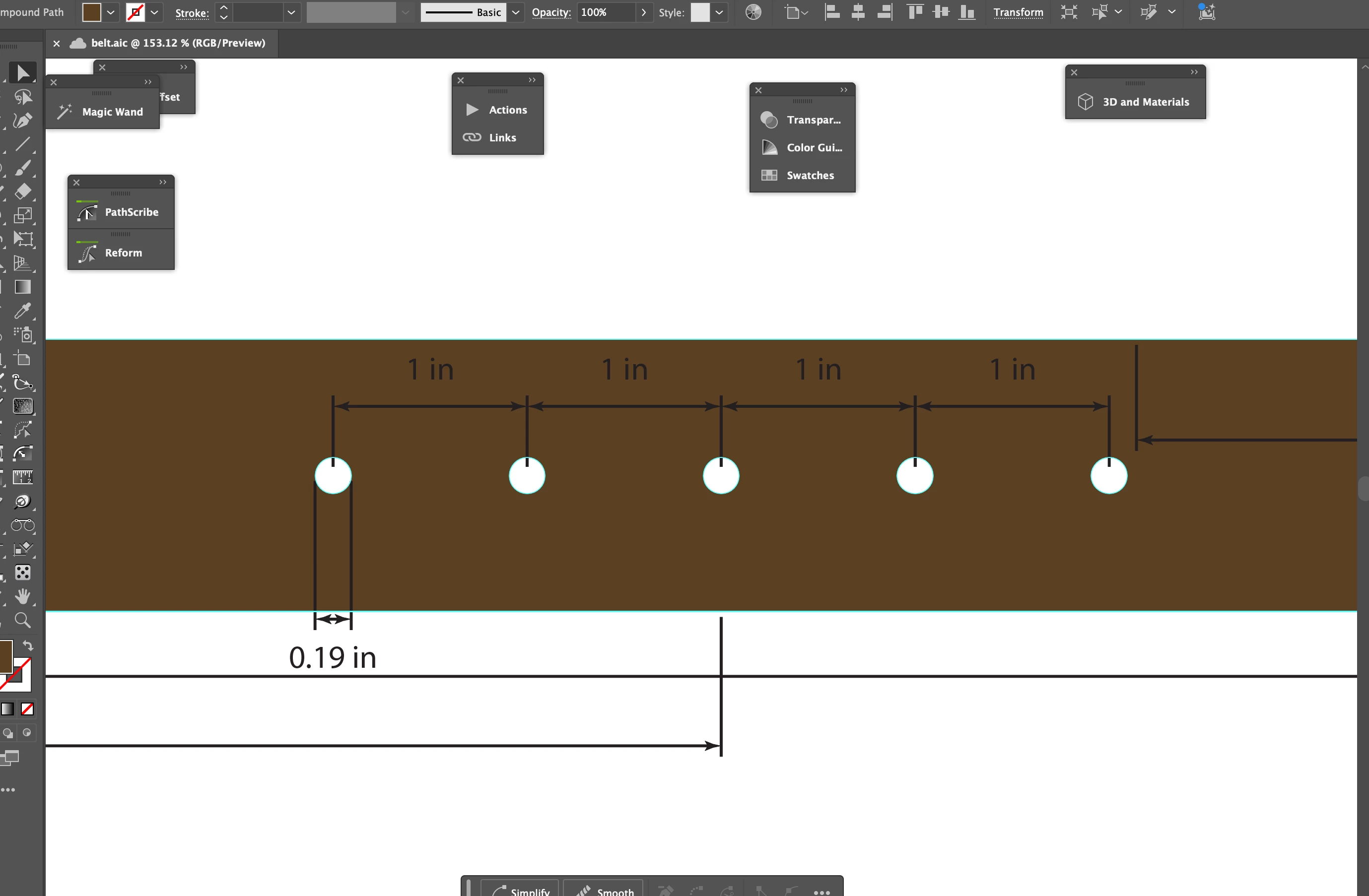

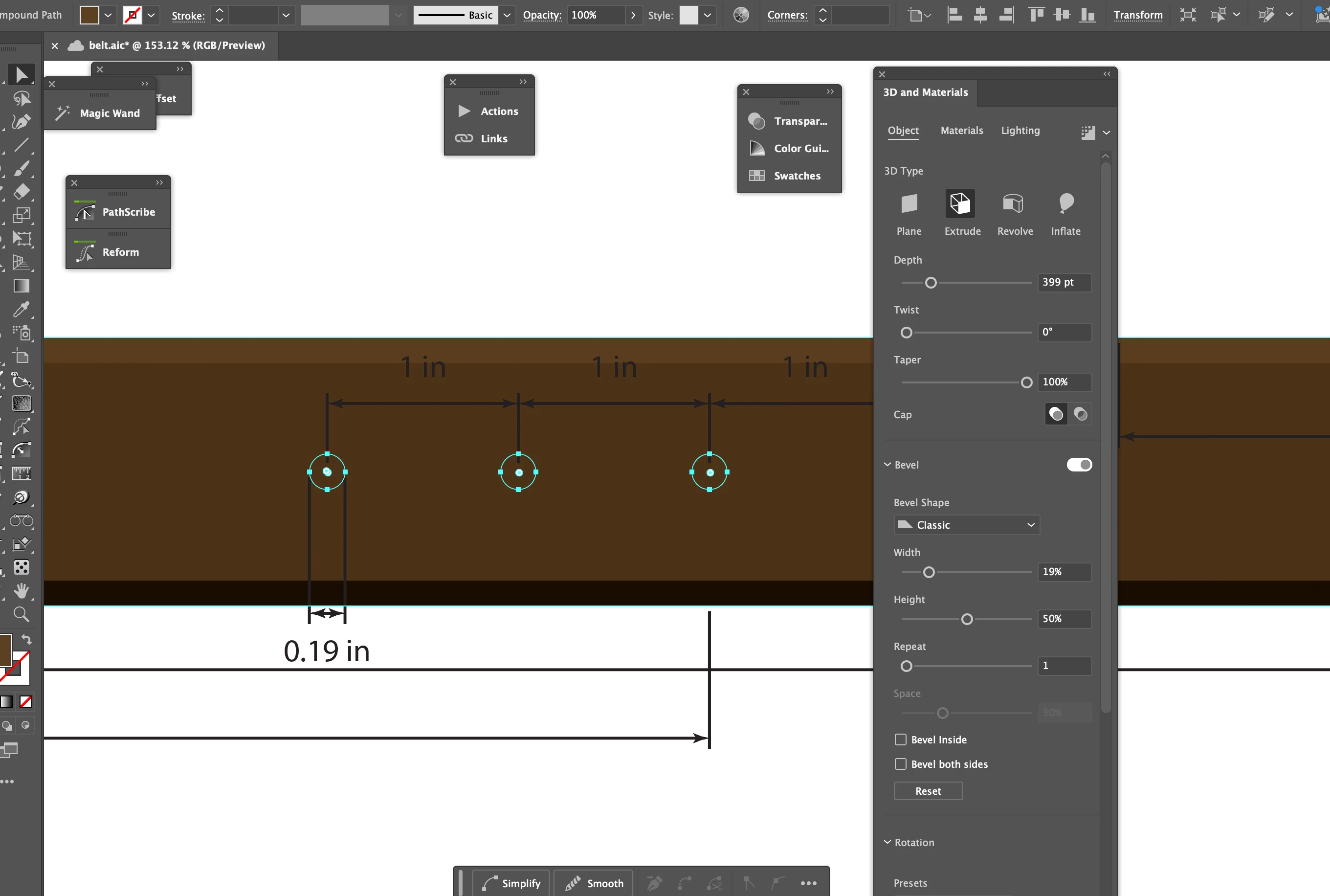

BROOO SAME. I have something kind of similar happen right now where im making a mockup of a belt with holes inside but no matter what I do to make those holes inside the "rectangle" which is my belt (wether its making circles and using the shape builder tool to remove them or the pathfinder or even recreating the shape entirely) EXTRUDE AND BEVEL (2022 version) IGNORES THEM AND ESSENTIALLY JUST GIVES ME A RECTANGLE AS IF THOSE HOLES WERE NEVER THERE. like I already updated illustrator, restarted it, expanded the shape, tried to see if it ignores other random shapes with holes (which magically it doesnt it only has an issue with this belt), etc. (side note: whats even crazier is the other day i was making this belt w the same holes just a little larger and it worked fine but now it just decided to ignore it its so unreliable)

Please share the AI file.
