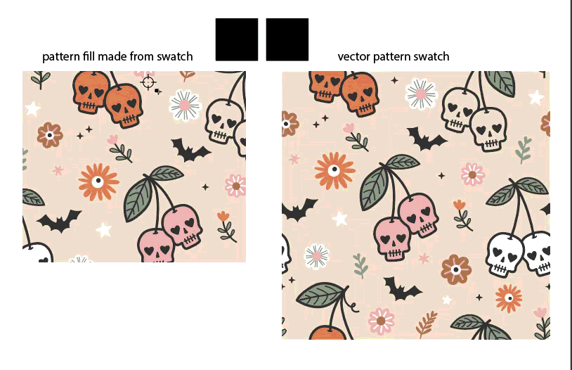

Eyedropper picking strange colors from pattern-fill shapes (holding shift)
If I eyedropper a color from the vector art or pixel image I use to make a pattern swatch, I get the correct color. If I eyedropper (with shift held down) over a shape that is filled with that same pattern, I get the wrong color. Not sure if this is a bug or just a complicated color profile issue, but it occurs only in pattern-filled shapes, whether the pattern is generated from vector art or from an embedded pixel image.
Anyone know what's going on here?
I've attached a screencapture gif of me doing this, because I feel like I'm going crazy and I need y'all to see what's actually happening.
The work-around is: I expand or rasterize a small shape off the artboard and fill it with the pattern, then color-select from that. With high-res images or complex vector art this can slow me down a little, but it works. It's just a baffling issue that's hard to catch and has lead to mistakes. Sometimes the color differences are less obvious than in this example.

Here's the file I was using.
I think I solved it, though, so I added those notes.  Looks like it was being caused by graphics card color management.  I changed my Nvidia Control Panel settings for Illustrator (and Photoshop) to always use the Nvidia card rather than deciding automatically, and now both the pattern fill and the vector art are displaying and grabbing the same color.
I suppose that means that pattern-fill color profile management was defaulting to the integrated graphics processor rather than my Nvidia, and now the Nvidia is handling both. I've attached a screenshot as well for historical reference.

Here's a file that's causing this issue for me, and a screencapture of me demonstrating the issue. I'm running 29.4
