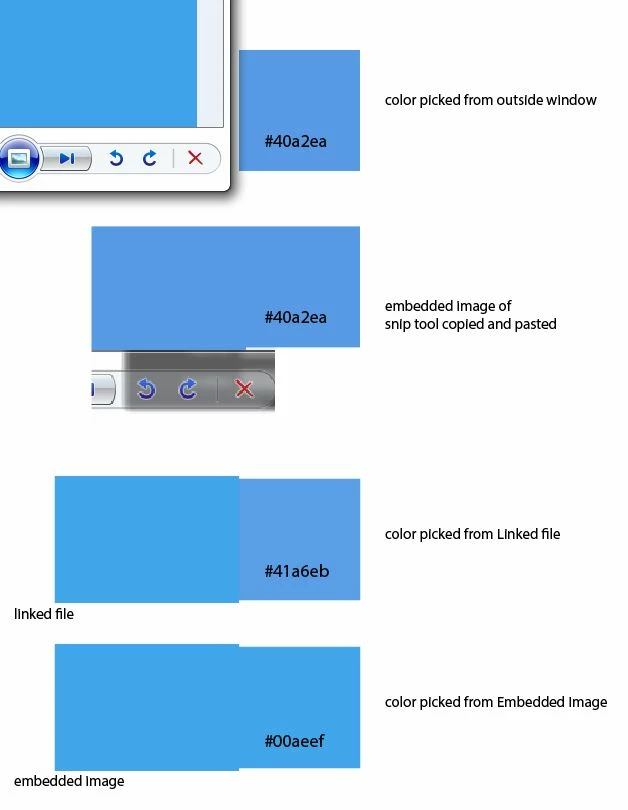

Hi everyone. I am using illustrator for about an year now. Recently found out that my eyedropper is picking colors in strange manner. Here are 4 different examples.
1. The original color sample is picked with the eyedropper tool from the image viewer window but resulted in different color #40a2ea
2. Here I used snip tool in windows 7 to capture the quick snapshot from image viewer and pasted the copied from clipboard. Illustrator pasted the image with the same color as picked in previous case.
3. In this case I directly dragged the original color sample file into the illustrator as a Linked file. then picked the color from it. Result was #41a6eb
4. I embedded the linked image now and used eyedropper again. Now it gives me the original color.
[I am using Illustrator cc 2015 3.1 with Document color->RGB and proof colors unchecked]
Please help why wrong colors are picked when simply using eyedropper tool to sample from an outside window.

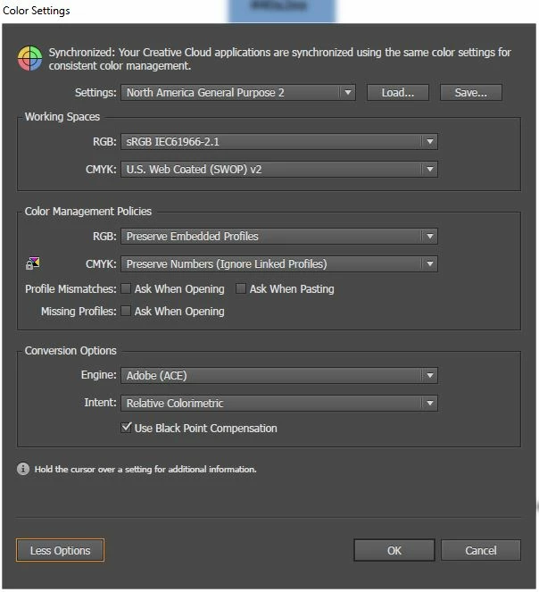

Hi, no problem.. I managed to solve this issue myself. The problem was with the color management profile.
In control panel->color management.. I changed the ICC profile to match with the RGB color profile in Illustrator->Edit->Color Setting
Now the illustrator is picking/sampling the correct color/fill/attribute from outside illustrator.

Hi, Thanks for the quick response. I understand that it picks up the screen representation of the color. As you can see in the first case I am just picking the color from the image viewer and the result is visibly different.
Also why there is difference in colors sampled between linked image and embedded image? embedded image results in correct color and the linked image is giving different color when picked..
