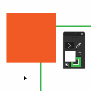

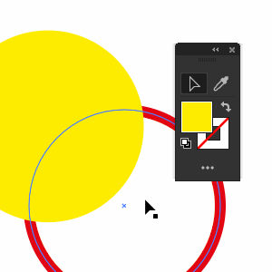

Eyedropper Tool Missing Smart Guides Highlight When Sampling (Illustrator 30.3)
Just updated Illustrator and now when using the Eyedropper tool, it no longer gives you Smart Guides to highlight the path that you are sourcing. How the absolute heck am I supposed to do this now? How can you see what you are selecting? This has ruined my workflow.
This is so absurd. Changing things that have worked fine for a hundred years and now you change it for no reason to something worse.
See attached images that visualize the issue perfectly. Credit to Egor Chistyakov.

    Hi everyone,
    I checked this further with the product team, and this behavior in Illustrator 30.3 is currently considered an intentional change aimed at improving color picking precision while using the Eyedropper tool. This is why Smart Guides highlighting is temporarily disabled during sampling.
    I understand this impacts existing workflows, and I’ve shared the feedback internally with the team. A bug has also been logged to further track and evaluate the concerns raised by users.
    Please also upvote and follow the UserVoice report below to stay updated on any future changes or improvements:
    https://illustrator.uservoice.com/forums/601447-illustrator-desktop-bugs/suggestions/50751686-picking-eyedropper-temporarily-disables-smart-guid
    Best,
    Abhishek
    <marking as correct for better visibility on the thread>
