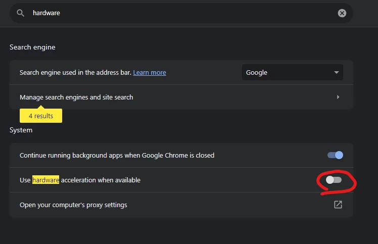

SentryBCorrect answer
Aug 19, 2023 2:47 PM UTC
If you have this problem on PC and it won't let you sample anything from the browser, it's most likely because you have hardware acceleration on in your settings. Turn it off and it will work fine!

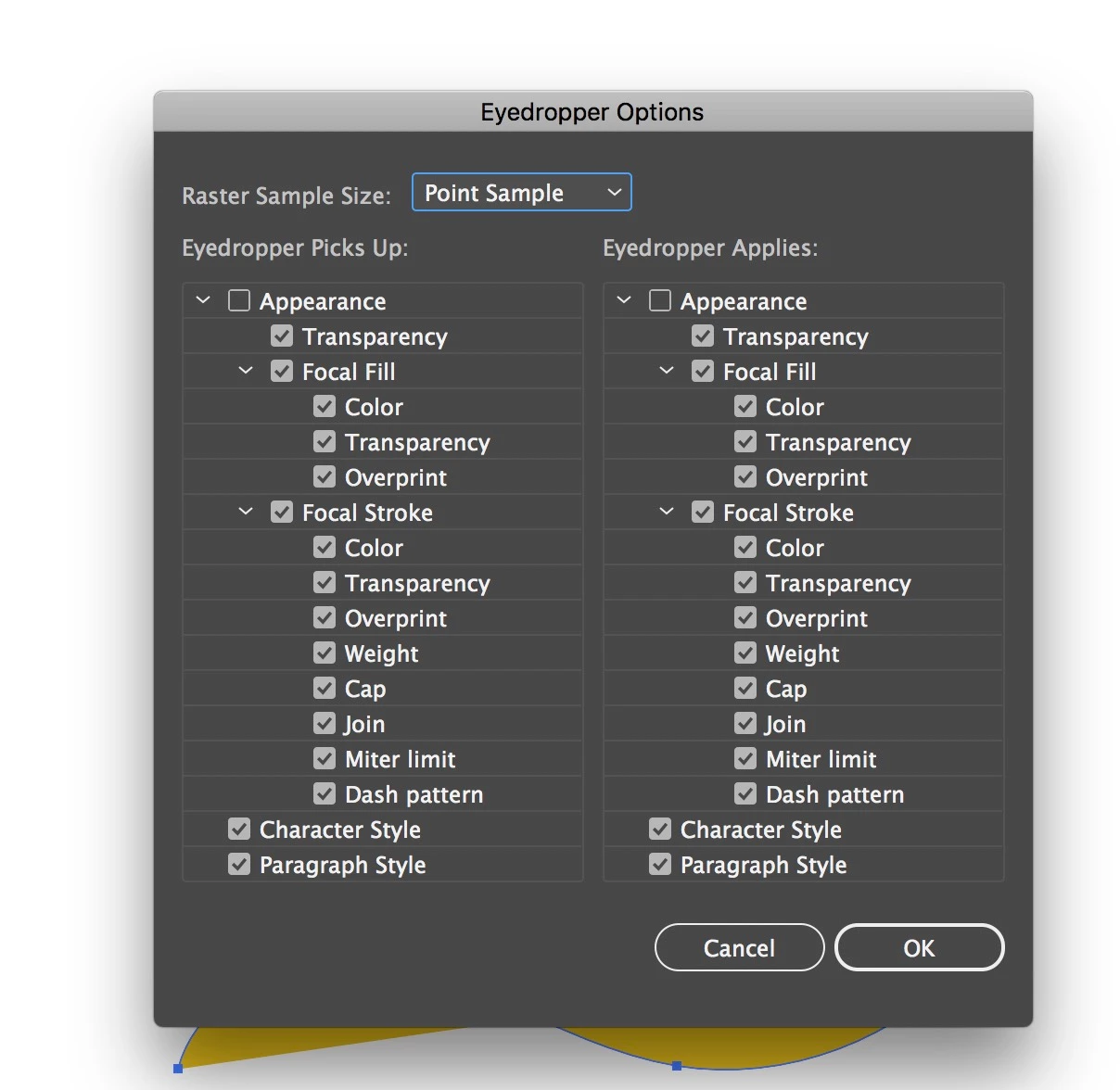

double click your eyedropper... check if your settings are as you like.
maaaaybe something there
shenaj22153905
Jan 24, 2020 12:48 PM UTC
Thanks for trying...they're all the same as yours.
