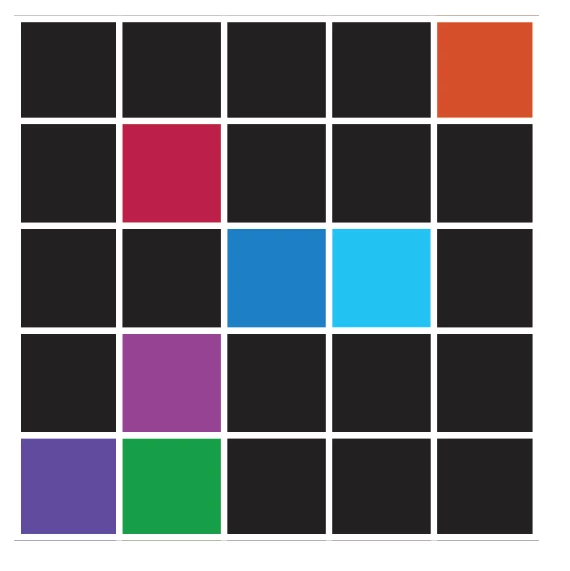

Faint, weightless lines appearing on the edge of overlapping shapes
These faint lines keep appearing when I create overlapping shapes, as can be seen at the very bottom and top of the image. It should be completely white like the sides. They change slightly when I zoom in/out. The paths are completely lined up and the only stroke is on the inside of the path. I don't know how to get rid/not see them. Is this a bug? I can fix it by making my shapes slightly smaller although it seems like there should be a better way. Running Adobe Illustrator CC 2018, GPU Preview. Any help would be appreciated!!

    Apr 21, 2018 8:09 AM UTC
    I am not sure what is exactly overlapping in your screendump.
    What happens if you turn off Anti-aliased Artwork in Preferences General?

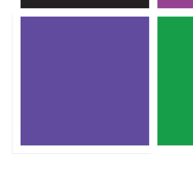

    Apr 21, 2018 4:38 PM UTC
    So for example, in the image below, there is a purple square and a zero-fill, 8 inside-stroke rectangle. Their paths line up in the corner, but as you can see some unwanted purple lines are appearing on the outsides of the paths.
