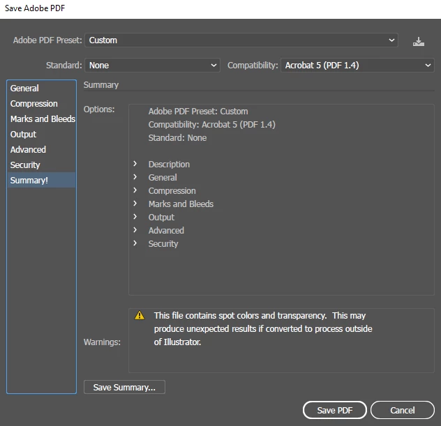

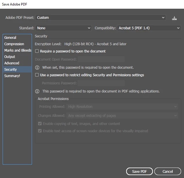

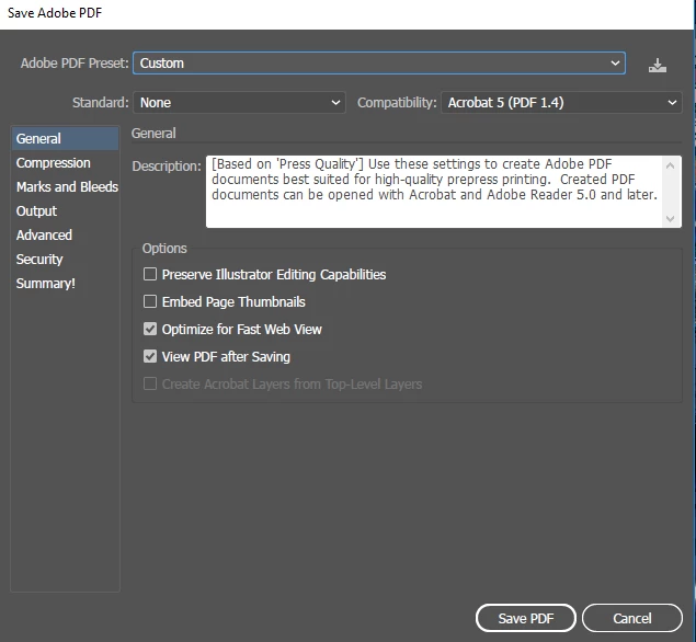

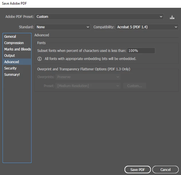

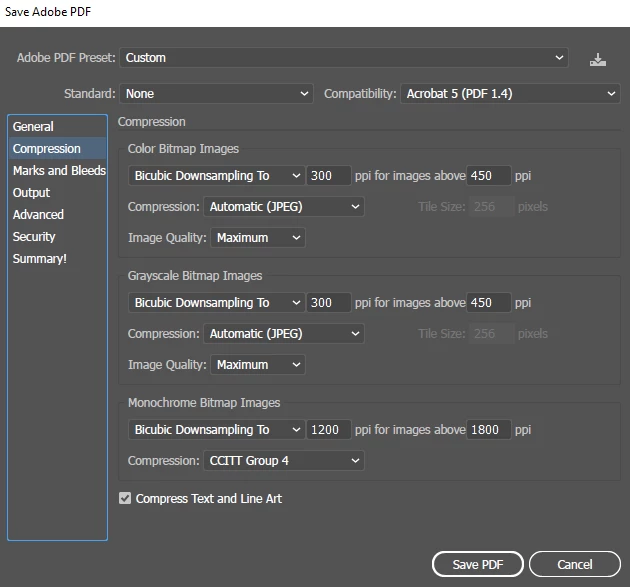

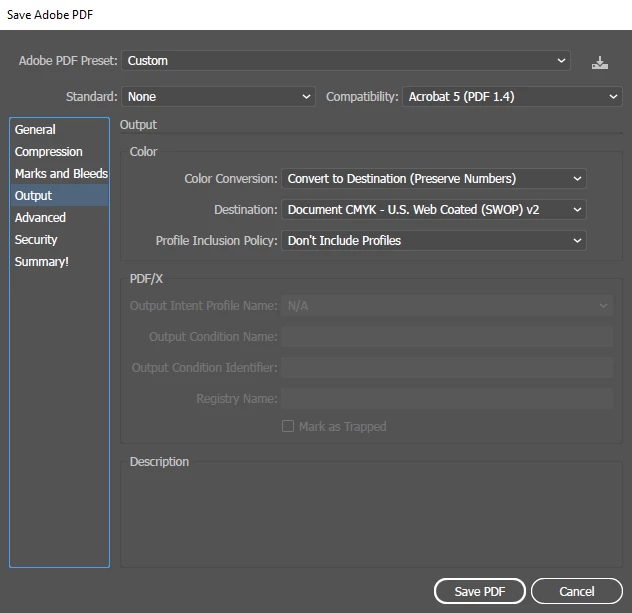

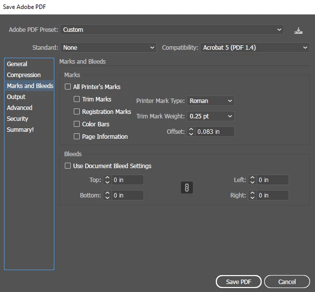

    This is exactly what I'm worried about, and simply just don't know enough about what to do there. Learning so much but new to the printing side. I'm really not sure how the hell to save it optimized, or what I should do. The illustrator file by itself is 251,000 KB and it doesn't have any images it's mostly all vector so that's got to be in my favor BUT over 700 layers and can't even count the paths etc so... When I save it with the settings in the screenshots below I get around 90,000 KB. A friend told me they print things that are over 1GB, and I shouldn't be concerned, however I don't have a means to get it printed at the moment, and my print lady said the file was too big at 65,000 KB. Not sure if her equipment is the problem or what. Just trying to get a solid answer here to have it the best quality I can get. I don't want to flatten the transparency or play with all the blending modes to save it since that's part of why it looks great. This thing means the world to me, and I've got people interested in it online, so hoping to figure it out.

    Are you SURE you want it at 300 ppi? This is a rule of thumb for printing small pieces, but it goes out of the window for big pieces - for obvious reasons, files are just too big for anyone! So, have you based this 300 ppi figure on a detailed analysis of your project and full discussion with the printer? Or are you just carrying the 300 ppi figure in because it seems good practice or someone once recommended it?  If in doubt, please tell us the type of printing you plan, and exactly how close the audience will be to the mural. The more you can tell us about the mechanics of this, the better we can give advice.

    on the save adobe pdf, uncheck
    Pieserve Illustrator Editing Capabilities
