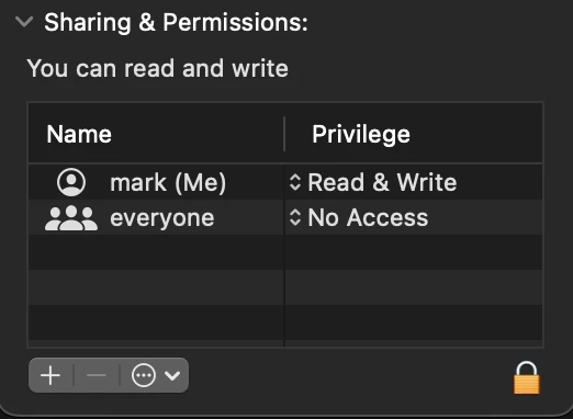

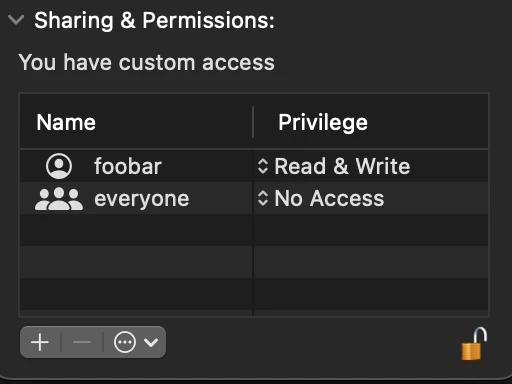

I was thinking the same thing, Monika. The issue may seem more confusing if the act of copying the script into the /Presets/Scripts folder in Applications changed the file permissions (in which case it would have asked user to authenticate as admin). That alone might explain your results.
I did the following test: saved a script on my Desktop., then changed the file's owner to another user account (not me) and removed other access privileges. Get Info looked like this:
Now when I run this script in Illustrator using Other Script... the script wouldn't run. (In my case it gave me no error message at all though.)
But then I copied the script file into Applications/Adobe Illustrator/Presets/Scripts and MacOS asked me to authenticate, which I did. And now Get Info shows this:
It has made me the file's owner, and now the script runs fine, even if I move it and use Other Script menu.
The easiest fix is to give the script Read access to "everyone". It is also possible that your installer system may alter permissions.
- Mark
- Mark
