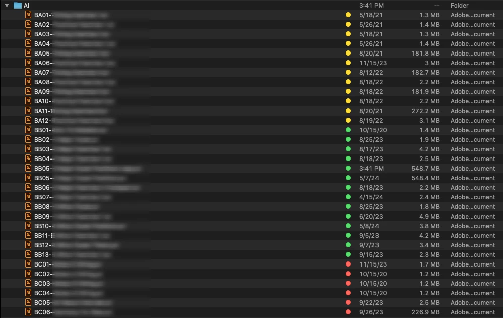

I just noticed some irregularities between document files sizes in a project I'm working on. For the longest while in this long term project of dozens and dozens of AI files, the average file size has been about 2.5MB. In some of the newer documents the file is over 500MB

*The only difference I can think of where I changed my procedure is the use of Library items. There are many many repeating elements that are used several times on every page. Just small elements consisting of a vector shape with a letter or number on a text layer. I decided to make use of libraries and I imagined this would streamline the design of the pages. I did not imagine it would bloat out the file size.
Would library items have this impact on a document? If not any ideas what wlse might be the culprit.

Well after some testing with the settings it seems using Compression at file save makes all the difference. Turning PDF compatibility off only saved about 5MB on a 500MB file. Using Symbols made no difference whatsoever unfortunately. But saving a new AI with Compression on reduced file size from 500MB to 5MB with no affect of read write times.
