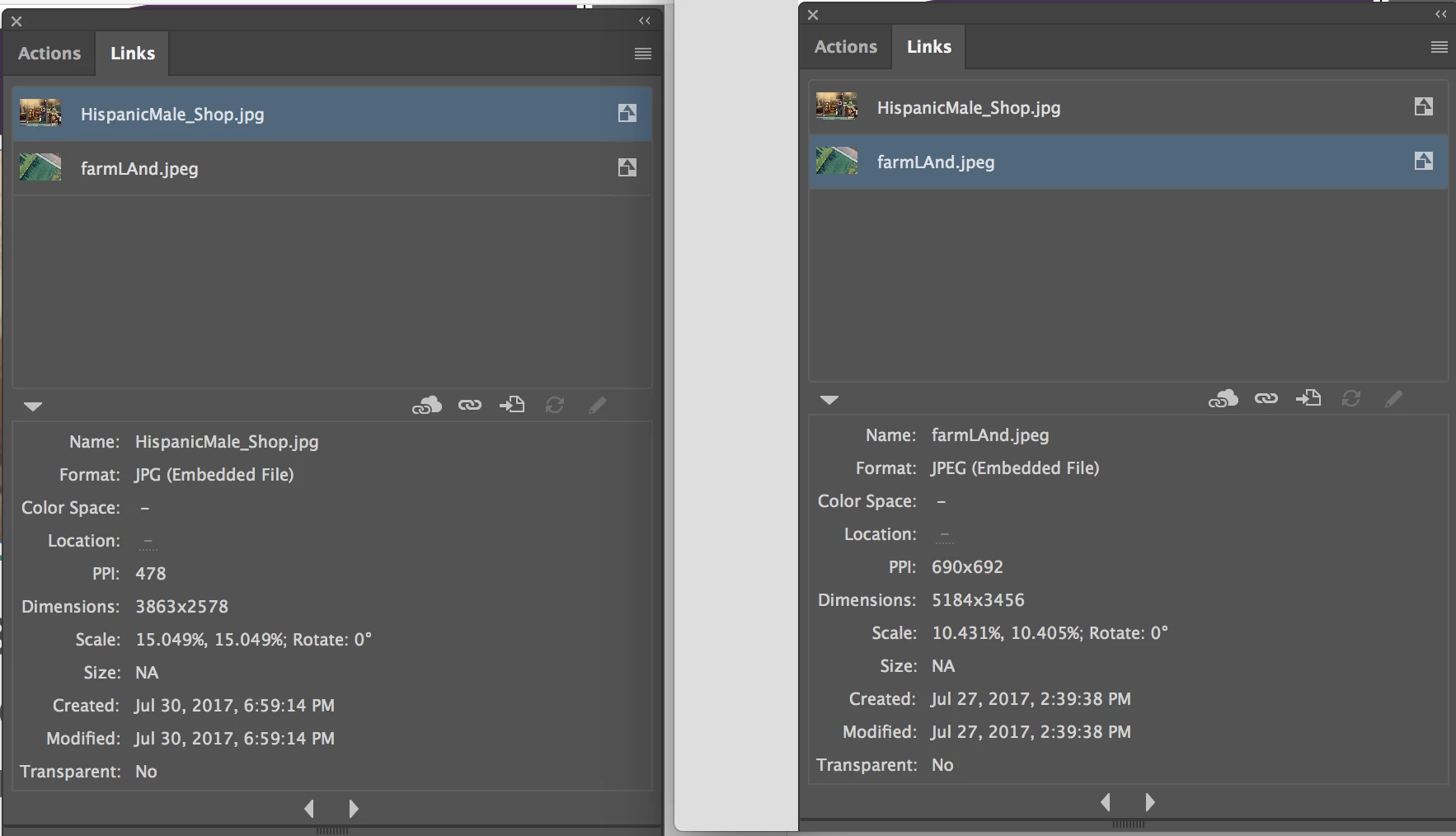

Also: those images are scaled to 15%. That doesn't make any sense at all.
First take those images into Photoshop and scale them to the exact needed size at the exact needed resolution.
Then place them into your AI file (preferably linked)
Then save a PDF to exact the specifications you need. Usually you don't need the AI editing features. So turn them off.  If someone needs to edit the file, send them the AI file and the source images.

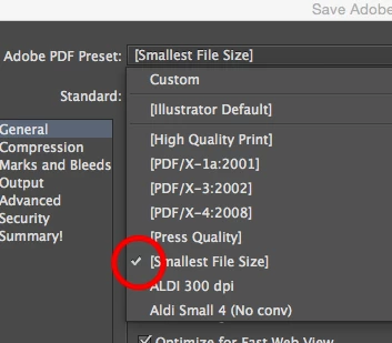

No Illustrator does not save history as Microsoft products. Yes the size of the pdf is affected by the size of the images, but excess piles are removed when making the pdf, but this depends on the settings you have used.
If you have already used a pdf preset  such as smallest file size, then open the .pdf in acrobat and use reduce file size.
When saving pdf in illustrator
In acrobat

What's the Effective PPI of the images? Did you scale the images? Have you done a Save As and overwritten the file recently? What are the Compression settings in your PDF?

to reduce the pdf size, prefer turning off "Preserve Illustrator Editing capability" and verifying that compression is selected while saving PDF.
