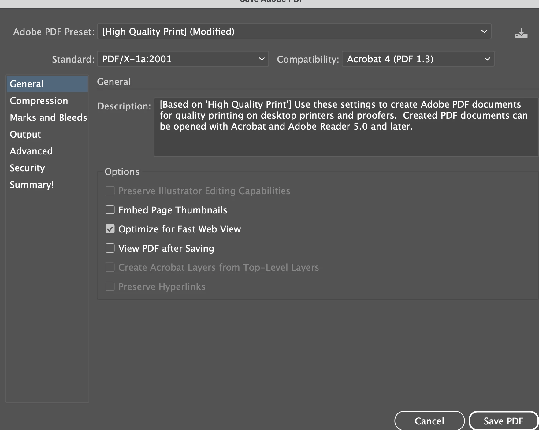

The original illustrator file was 2GB, its now half that size.  When I save it to pdf though, it seems to jump up a bit again.  Screenshot of settings attached.
