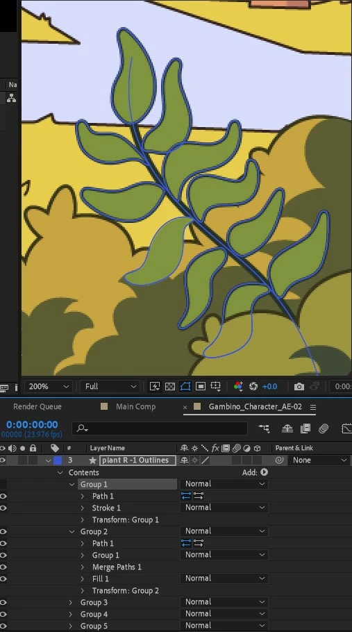

Hi. I am currently trying to prepare an Illustrator file and import it into After Effects, so that I'm later able to animate it. Main issue is that once converted to a shape layer in AE, the fill and stroke for each object in that layer are in a separate group, for example, I end up having 16 groups when I should actually have 8.
Here's a look at my proccess for more info:
- AI Layers are Released to Layers (Sequence) before importing to AE.
- AI File is imported as a Composition, and I retain layer size.
- Create shapes from vector layer.
I have provided screenshots that show separate groups in AE for a plant illustration where I would like each leaf to be in its own group, but instead, it splits the stroke and fill into Group 1 (stroke)  and Group 2 (fill), same goes for the rest.

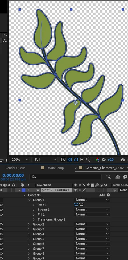

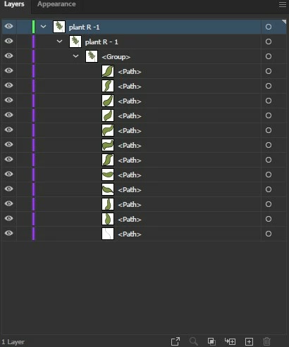

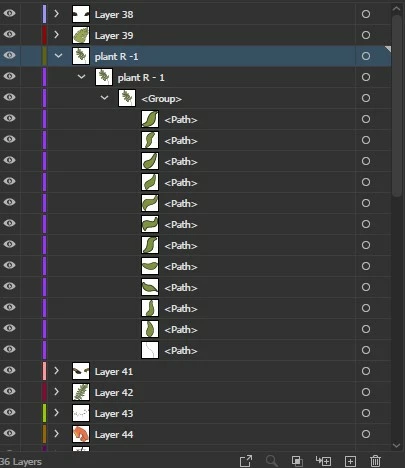

Only "fix" is to repeat the same proccess, but instead, delete every other layer in Illustrator and keep the plant only (named "plant R - 1"), which gives me both the fill and stroke for each leaf in a singular group as intended. Not sure why it works this way when the process and layer hierarchy is the same, there's gotta be something I'm missing when I release to layer (sequence) accross all layers at once. I also tried doing it individially for each, but it ONLY works when I delete certain or all other layers, so its possible that its an issue with another layers' grops or clipping masks.

I just went through each layer and found that the issue was that some objects were not in Normal blending mode and 100% opacity. I simply reset them back to default and that seemed to fix everything once imported and converted to a shape layer in After Effects. I appreciate the help!

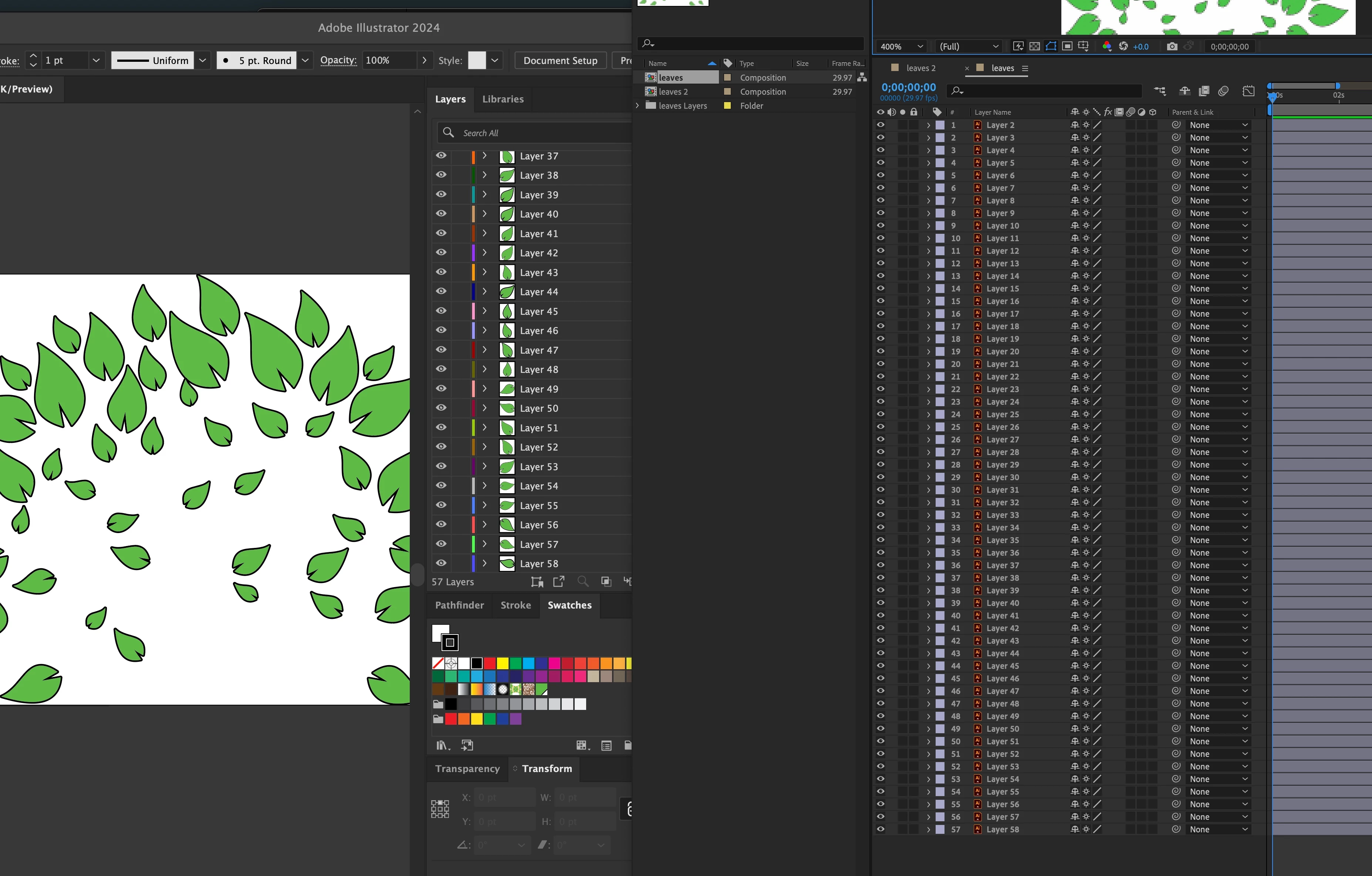

Mike_Gondek10189183
Aug 6, 2024 2:27 AM UTC
Works fine for me. Try to simplify to not have subgroups.

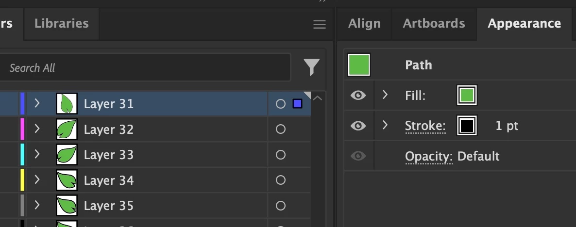

Also do you have one vector object for each leaf, or do you have  fill object, and then a stroke object?
Check that your appearance looks like mine for each leaf.
