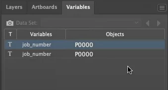

Can any help me shed some light on why I cant seem to us a single variable from a CSV file and link it to multiple text string objects?
I've made a video showing you exactly what I'm doing... https://www.youtube.com/watch?v=1TX4TrC8glI

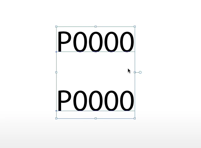

So I make text objects and select them both...

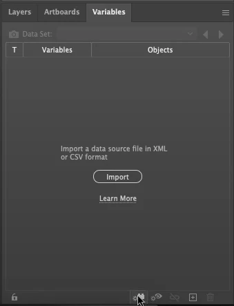

I then go to the variables panel and click the Make Text Dynamic button...

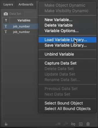

I then rename both variables to job_number

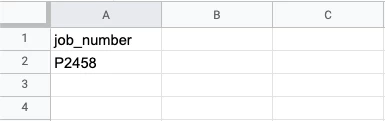

I then create my CSV file...
I then load the CSV file by selecting Load Variable Library from the Menu...

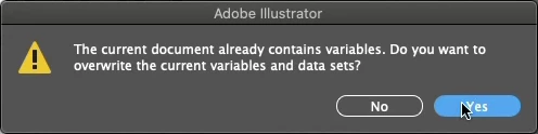

I then get this dialog to which I click Yes...

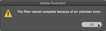

Which then shows this ERROR dialog!
What am I doing so wrong here? Makes no sense.
Surely this has to be software issue? It's completely rendered my application for this if I cannot use a single variable to populate two ojects with the same data.

HI @m1b , thanks but I don't want to import first? That means i'll manally have to link up aftwards right? I need all variables set before import as this is master template many people to use.  Unless you can elaboate a bit more with the Load Variable Library import being last.

is this a new issue? was it working before an update/upgrade?
Can you confirm the exact version of your software and operating system?
Can you also confirm how you save your CSV. Did you try to open it in a basic text editor to check the structure and resave that. just to 'purge' any extra added by Excel/Numbers
October 11, 2022
Currently using version 26.5.
This is a new issue. But surely this should work right? The same result on my collegues machines too?
The CSV is generated from a Google Sheet download and I've checked it text editor...
`job_number`
`P2458`
That is the contents, nothing else.
