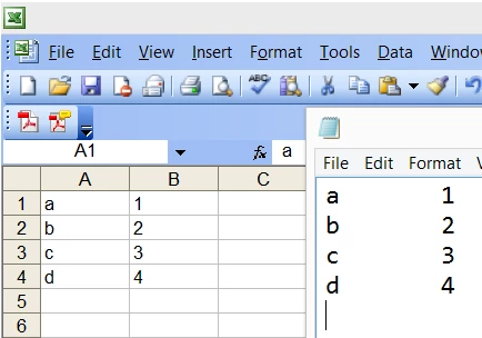

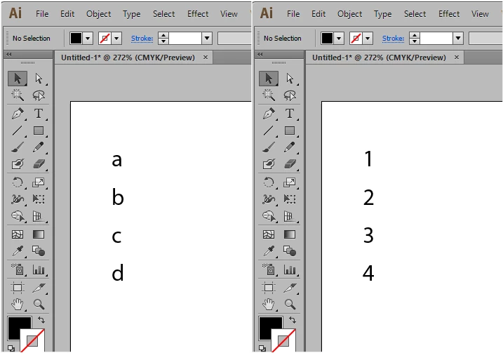

I don't know about reading xls files, but if you copy xls columns into a txt file, columns are separated by tabs and rows are separated by new lines.  The snippet below will read a txt file and change the textFrame contents from the first column to the second column.
var file1 = File.openDialog("prompt", "*.txt");
file1.open("e");
var contents1 = file1.read();
file1.close();
var contents2 = contents1.split("\n");
var contents3 = [];
for (var i = 0; i < contents2.length; i++) {
    contents3[i] = contents2[i].split("\t");
var frames = app.activeDocument.textFrames;
for (var i = 0; i < frames.length; i++) {
    for (var j = 0; j < contents3.length; j++) {
        if (frames[i].contents == contents3[j][0]) {
            frames[i].contents = contents3[j][1]

THANK YOU SO MUCH! Can I buy you a coffee or a cocktail or something?
