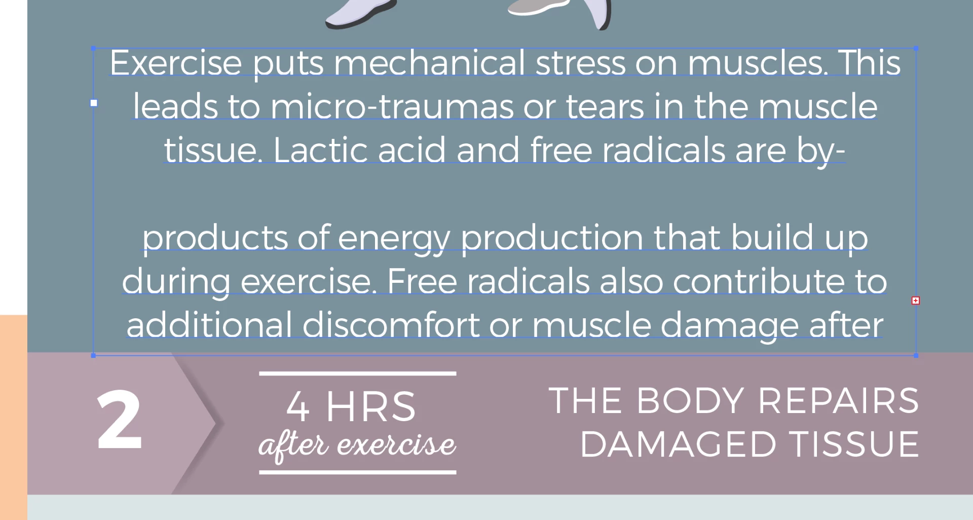

I know there must be a quicker easier way to do this, but I've looked all over the forums and can't seem to find anything!
So, I'm making some infographics in Illustrator. I often have to go in and edit text - make it longer or shorter. I'd like the bounding box of the text to somehow easily fit to the amount of text in the box, similar to 'fit to frame' in InDesign.
I often end up with a box that has overflow text like so
Or the box is way too big for the text and gets in the way:
Is there a way to easily and quickly resize this text box to fit the amount of text within?

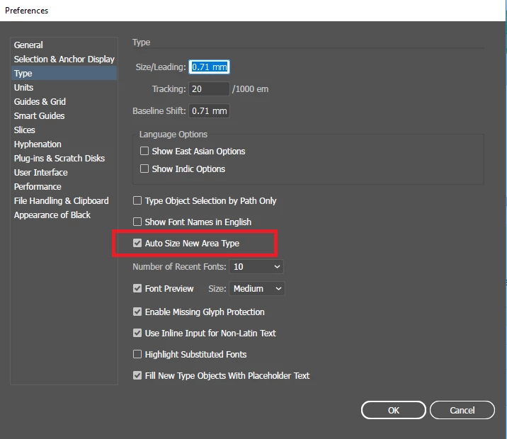

    "Checkbox" which Monika is referring above is "Auto Size New Area Type".
    Srishti
    sarahpeller
    August 29, 2018
    Thank you for these ideas, but I'm still needing to manually drag each corner of the text bounding box to resize for the text inside... Perhaps this only works with newly created text boxes? Maybe I need to explain better what I want to do...
    For instance, here I added a paragraph break to make the text overflow. The only way I know of to fit the box to the text is to use the direct selection tool to select the 2 anchor points at the bottom of the box, then drag the bottom line down to make the text box adjust. There must be a quicker/better way, I just don't know it yet. I do have "Auto size new area type" checked in prefs, by the way. I'm not sure how that function is meant to work because it didn't change anything. Thanks so much for all your ideas! Excited to hear more...

    Monika Gause
    August 20, 2018
    You can adjust it in Preferences > Type. It's a checkbox that the bounding box should always adjust.
