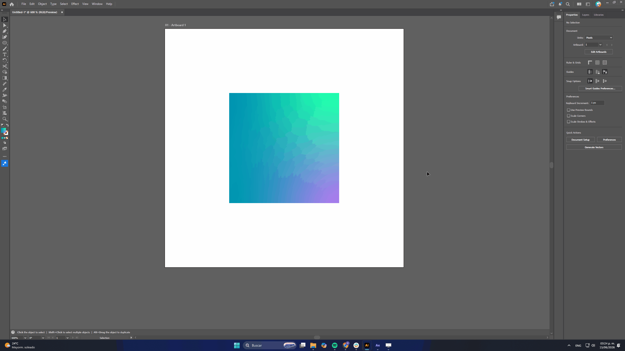

I tried resizing my artboard to match my object's size and it seems they don't match.
My square object is 50 px x 50 px, and the arboard size is 60 px x 60 px. How to solve this? I didn’t struggle with this issue before.
Attaching the evidence. Thanks for replying and sharing your solutions

I guess the square is filled with a Freeform gradient.
If so, the reason for the issue is that Freeform gradient objects have extended bounding boxes for some reason (you can usually see it by turning on the Use Preview Bounds option in the Align panel).
You are facing this (mis-)behaviour since the bounding boxes are the basis for the "Fit to" commands.

Yes, I think this was the “issue”. I tried with a solid color and the resize artboard matches perfectly with the size of my selected object. Thanks for explaining.
