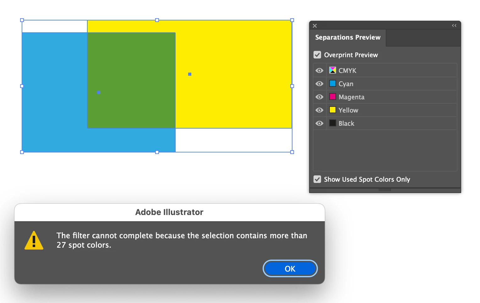

Flatten transparency not working because its saying i have too many spot colours but i have no spot colours in my art

    ​@Rachel38744444mgd4 I can replicate that  behaviour.
    If I have more than 27 spot colours in my Swatches panel, I get that message, even if I use only 2 process colours.
    When you use the Separations Preview, they all get loaded even if you have “Show Used Spot Colors Only” checked.
    You can avoid it by using Select All Unused in the Swatches panel and delete the swatches.

    thats a bit annoying considering i need all those swatches still in my file. Ill just bring my art into a seperate doc to do it and then bring it back to my original file afterwards. thank you for a speedy response. This solution has worked

    Good to hear that worked. You could also save the spot colours as a Swatches Library to avoid having them in your Swatches panel.  That way you can load them as a separate panel.
