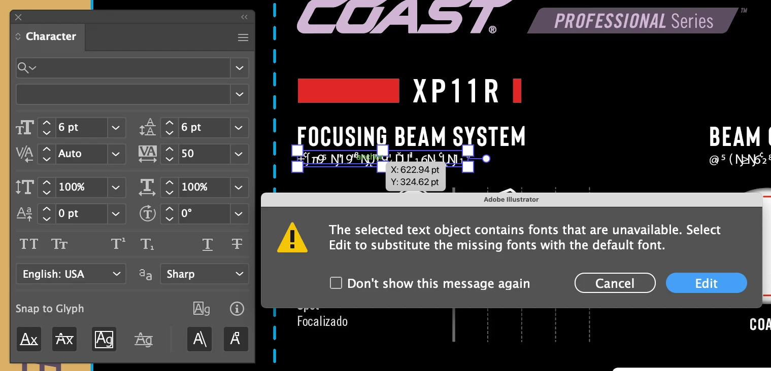

I've also had this issue on more than ten occasions using Illustrator v29.6.1. When opening a file, some fonts will be changed to Myriad Pro with no indication (other than appearance) that there are missing fonts or that font substitution has occurred. Myriad Pro is the [Normal Character Style], and I can see that it's applied that style with overrides for size and weight (at least). The strangest part is that it's not always every instance of the same font. Sometimes, only a single type block will be substituted; sometimes, only a single weight; and sometimes, a whole font family will be substituted. Closing the file without saving, restarting the computer, and reopening the file does not fix the issue. Our workflow requires saving Illustrator files and PDFs with outlined type for deliverables. This provides a good paper trail showing that fonts were correct when the file was last saved.
I've seen this with Trade Gothic LT Std and Bison.
Now that I know it's not just my system being uniquely buggy, I'll start collecting screenshots.
July 25, 2025

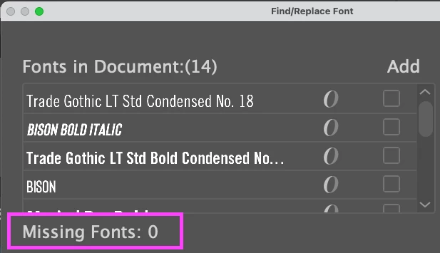

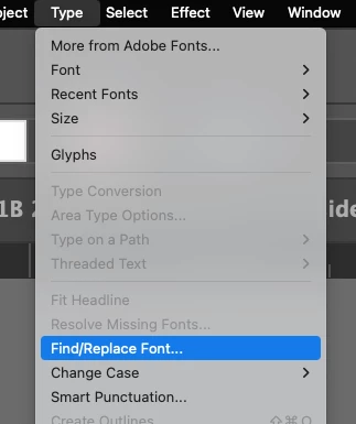

OK. Here are screenshots with a slight variation on this theme. In this case, the default character style is coming from the dieline created by the factory. I canceled out of the warning in the first screenshot, went to the Find/Replace Font menu item, and the Find/Replace dialog says there are no missing fonts. I scrolled down--Nope, nothing in the list. Since there isn't a font to substitute in the list of document fonts, each instance of the messed up font has to be changed individually, and it is very easy to miss some, especially if there are single characters, like numbered call-outs.
