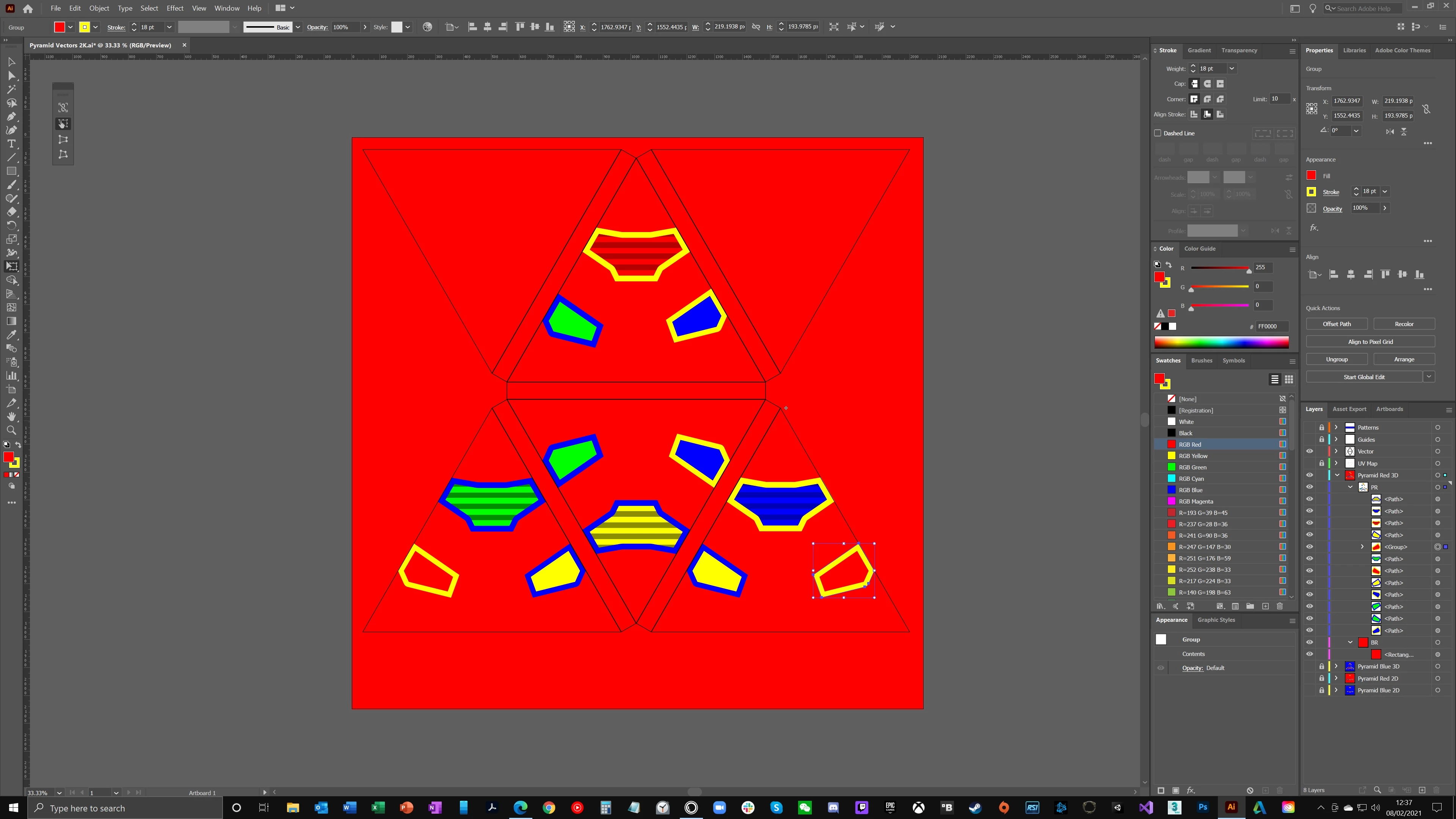

Well if you have a look at the picture you'll see that I have an object selected in the lower right and the transform centre is near the top of the lower right triangle. I would like to snap the transform centre to the top of the triangle. However I can find no way to do this.
