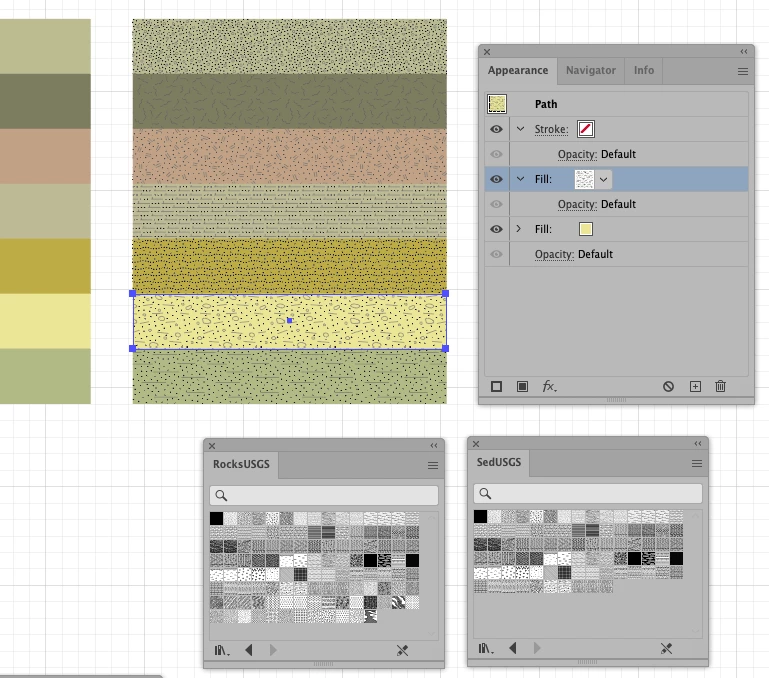

kphotopage
January 24, 2021
REGHAIS5EC8, Hi.
You may find this link very helpful. USGS Pattern Swatches for Illustrator.
https://blogs.otago.ac.nz/si-geology/resources/illustrationgraphics-resources/usgs-ai-pack-instructions-and-download-link/
Shown here, I created a rectangle with a Fill color.
In your Appearance Panel, (Fly out menu) Add New Fill
Select an USGS Pattern Swatch. You can play with Blend modes or opacity if you wish.
K
