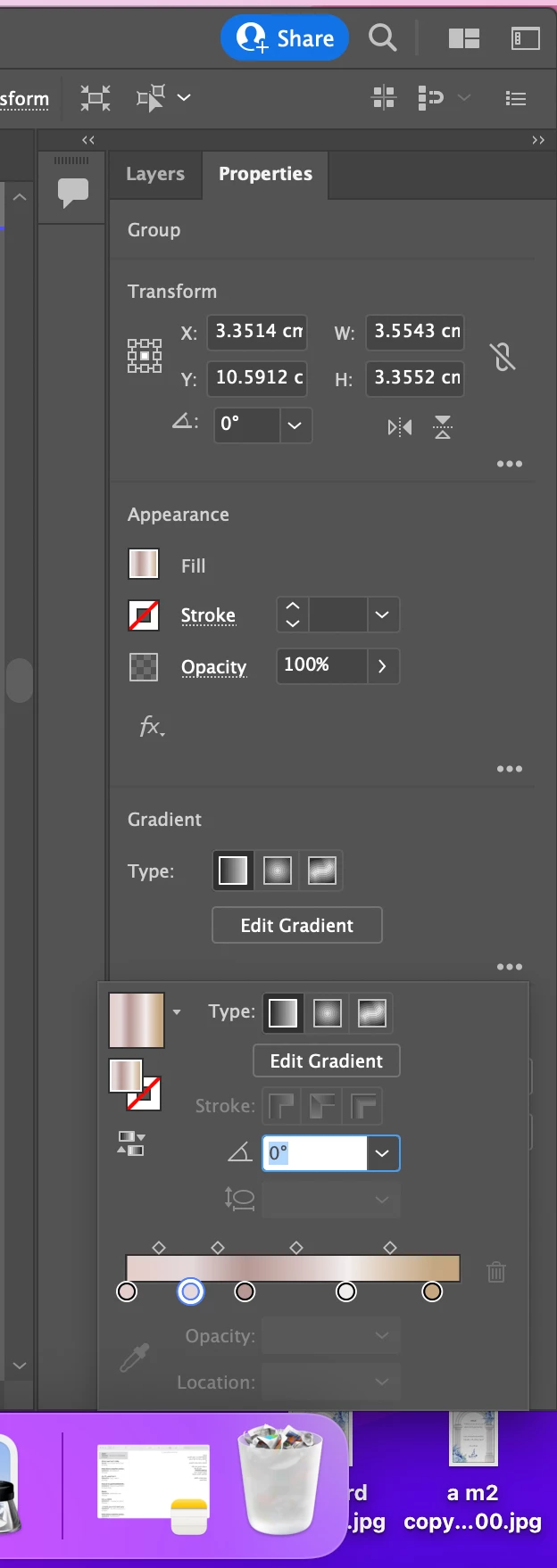

June 23, 2022
Can you share a screen shot of the gradient panel with the selected object?
israa5FF1Author
June 24, 2022
You mean this one?
and thank you for replying
Kevin Stohlmeyer
June 24, 2022
Im guessing without having the actual file that such a small object (3.35 cm) wiht this many and shorter gradient breaks is going to cause some issues when rendering. Illustrator cannot resolve the transition smoothly so it is converting it in to solid color breaks or "stepping".
If you apply the same gradient to a larger object does it appear ok?
