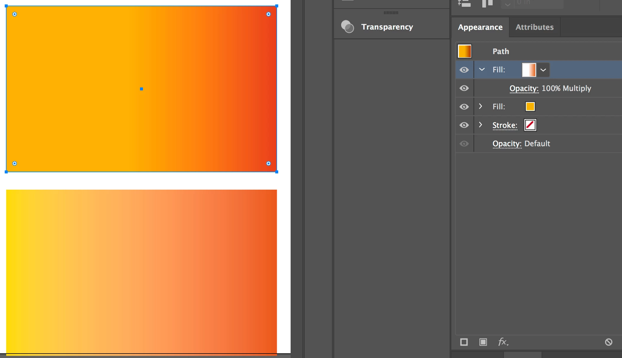

    To get that color gradient you should instead multiply white to orange gradient on top of a a solid yellow fill.  The yellow fill will act  like a printer does when you paint a wall giving you better solid color with less pinholing. You will get a richer color in the middle rather than a washed out look and screen angles fighting with each other and and less problem with  banding  from mindot.
    I would remove the 3% scumdot in cyan, to get you down to 3 inks. Or better yet use a spot yellow instead of process depending on what rest of art looks like.
