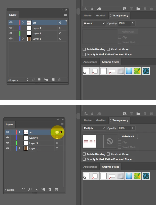

I'm trying to follow this Envato tutorial.   In it, the author has a simple radial gradient from white to 0% opacity.    Somehow she's set it up so that the white obscures everything below creating a nice vignette.   I have the source file but I can *NOT* figure out how she did it.   I've tried every different blend mode, checked appearances, masking mode, etc.

    Correct answer Arn Sweatman
    I figured it out - tho I can't explain how to describe this technique.
    The LAYER Blending Mode is set to "Normal.    But when you select the little radio button to the right of the layer name ("art"), THERE you change the Blending Mode to "Multiply".    Now everything below the radial blur IN THAT LAYER will be masked off.    This is different behavior from Opacity Masks.
    Thanks for all the suggestions.

    Arn Sweatman
    Arn SweatmanAuthorCorrect answer
    December 9, 2018
    Ton Frederiks
    December 9, 2018
    That is not a mask, but a Layer Blending Mode.
    It is not a gradient mask, it blends with all layers below it.
    It may look like a mask when you have a white layer below it, but it will be different with colored objects below it.
    Arn Sweatman
    December 9, 2018
    The layer blending mode ended up being the solution to the *gradient mask* to which it was applied.

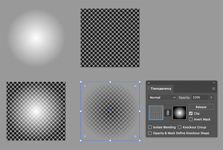

    Guessing:
    Fill an object with the gradient and put it on top of everything you want to obscure.
    Select both the object with the gradient and everything you want to obscure.
    Go to Window > Transparency and click: Make Mask
    Depending on the direction of your gradient, check Clip or Invert Mask
