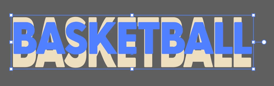

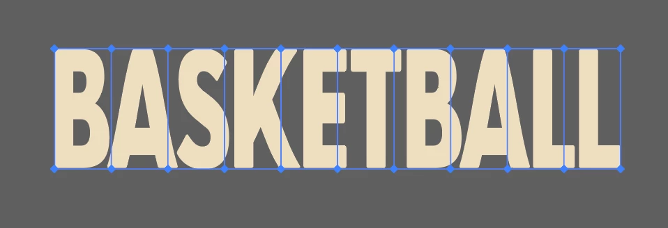

Hi Peter,
It's not clear where you got your information from but it is most definitely possible to make a gradient mesh directly from a type object (as seen in attached photos). It is clunky to work with but not "impossible" as you said.
Monika Gause
Oct 7, 2024 11:06 PM UTC
That is not a gradient mesh. You made an envelope.
