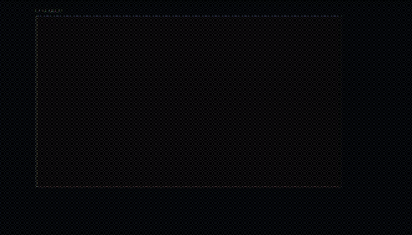

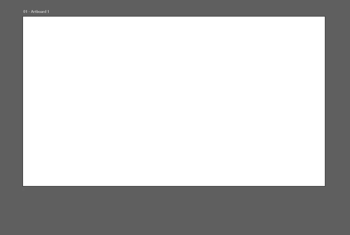

When I launch illustrator and the program is in GPU preview on my monitor I get a very strange graphic glitch.
CPU Preview - Normal
GPU Preview - Glitchy
The program is in version 30.8.2 but the same issue existed on the previous version as well as I just updated to this version to see if that was the issue.

    Hello @Mat.bjerner
    That does seem strange. Are you running Illustrator on Windows? If yes, please try performing a clean reinstallation of the GPU(s) driver (Intel / NVIDIA / AMD), set the Graphics Preference to High-Performance for Illustrator (https://adobe.ly/4yu1NkR), and check if it helps.
    If you're using a Mac, try running Illustrator under a different administrator account (macOS) and share your observations.

    Oct 9, 2026 5:40 AM UTC
    I have now tested this and setting the Graphics Preference to High-Performance for Illustrator solved the issue. I have recently hade to move profiles on my computer so this setting was probably on before but was removed when I switched profiles and thus I had this issue emerge. Thanks for the help!
