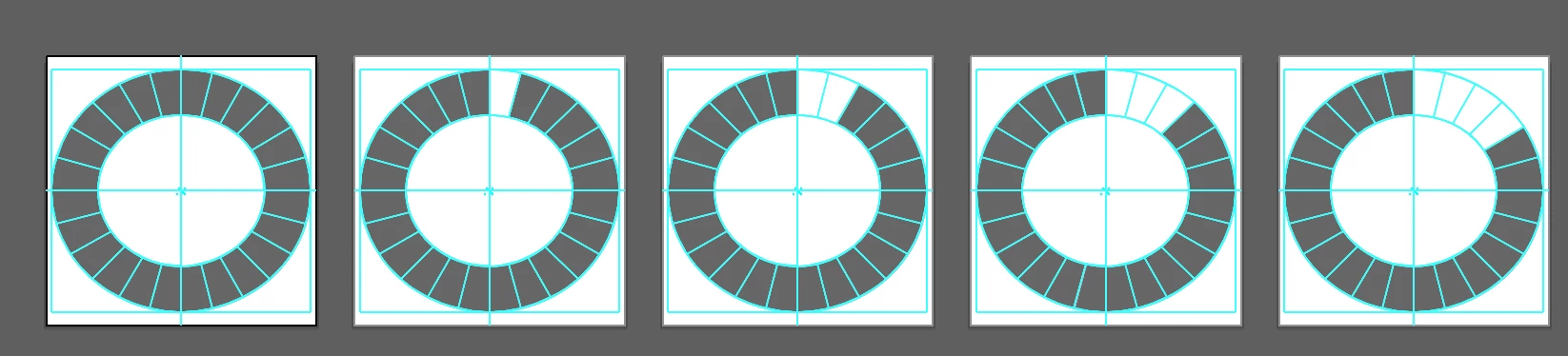

Hi
I am designing a screen loader... below is just a skeleton of the initial setup so you get an idea. There are 48 artboards. Each has a guide, each is placed precisely and then the segments removed one by one... like frames. I have checked and double checked this.
However, when I go to File>Export For Screens and view the sequence in Preview by selecting through them one-by-one, the graphic on the pngs is not sitting in the same place - there's a tiny shift on some and not on others. I redid the whole lot and the same thing is happening which makes me think it is a render issue.
Each object is 48x45mm in a 50x50 box.
Any ideas?

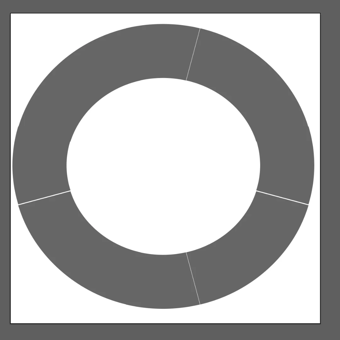

    This is my current artboard set up...
    When I selected 'Align Artwork to Pixel Grid', this happened... but I need the segments in the right place for the loader to work?
    This shows that your artwork is not prepared for the job. A few posts before you said it was aligned. In that case it might have move, but should not distort.
    Also: W + H of course should be round numbers, but X and Y (position) as well.

    They are part of a logo so I have to use the right shape.
    I realised I was working in mm so I am now adjusting the artwork to pixels (with no .00) to see if it helps.
    Abambo
    October 4, 2017
    Even if they are part of a logo and you need to respect the design -- as you should do with all logos -- you need to adapt to the physical requirements of your output media.
