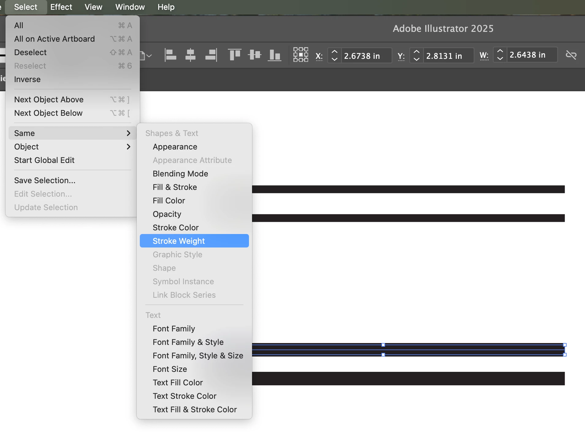

Hi @megan_0350,
There is an option to select the same stroke weight. Once you've selected the same stroke weight, while selected, you can then change the colour to the new black.

Hi @megan_0350,

I was unable to edit my post, but I am aware of the "Same" functionality.
I was hoping to find a GREP solution to speed up the process, as there would be thousands of assets to edit.
