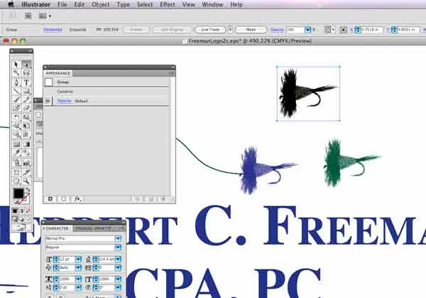

    January 20, 2012
    Place the flattened grayscale tiff in Illustrator. Select it with the Direct Selection tool - click on the color palette for None. Then click the spot color (or other color swatch) you want.
    It works for me - though I rarely have to color tifs in Illustrator this way. THis ugly business card came in designed in 2 spot colors. I had to change the cpot color for the blue from one PMS to the other.
