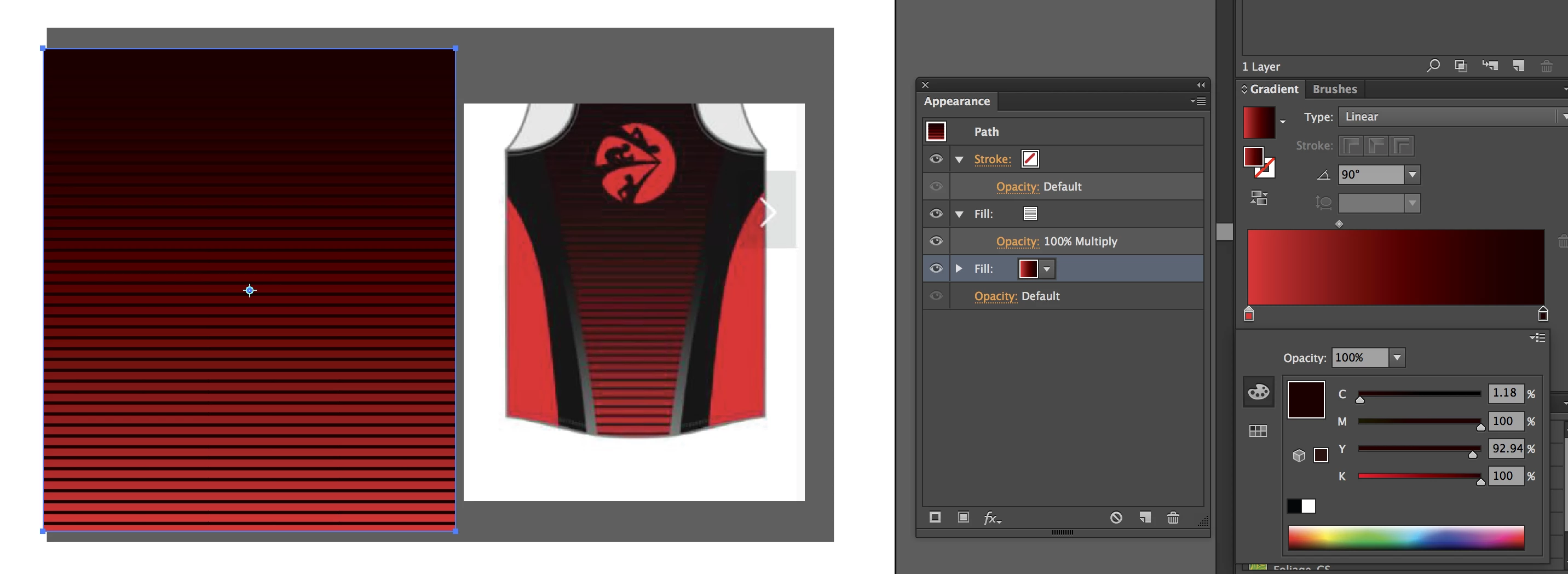

Hi everyone. I have tried recreating this but not successful.
My first step was created a gradient background from black to red, the first image. But the gradient has a white in the middle because of the gradient effect. How is the effect on these just from black to red? Then I put the lines pattern on top. Am I getting this wrong? I am only concern about the middle part of this.
Or are those halftone gradient lines?
Thanks for your help!
Cin
Correct answer rcraighead
It looks to me like the lines are evenly spaced. You could simple add a pattern fill something like this:

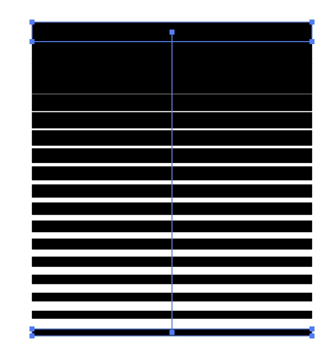

If the lines DO get progressively smaller Monika has the answer.
tromboniator
January 29, 2020
Hi, Cin,
From your description of the gradient problem I'm guessing that you are in CMYK mode and using pure black for the dark end of the gradient. If you look at rcraighead's screenshot of the gradient panel you will see that the black has magenta and yellow added. This will reduce or eliminate the "white" effect. You could also add a red gradient stop or two with increasing amounts of black as you get closer to the black end, and play with the positions and spacing.
Peter

rcraighead
rcraigheadCorrect answer
January 29, 2020

January 30, 2020
Hi rcraighead, that is so bang on. Sadly I can't see the details of your screenshot! 😞 I think the doesn't doesn't get smaller..it just seems to get darker which you got it.
So what was your steps? You created that gradient background and added the pattern (lines in this case) fill on top?

Monika Gause
January 29, 2020
Make a blend between a thin rectangle and a thick rectangle. Then mask it.
