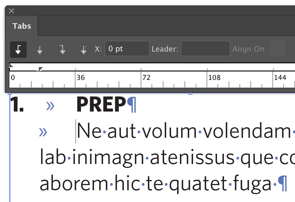

Does Illustrator behave like InDe in the following situation?
I could swear previous versions of Illustrator used to behave the same way as InDesign in this situation. Is this a bug? User error? Or I could just be wrong?

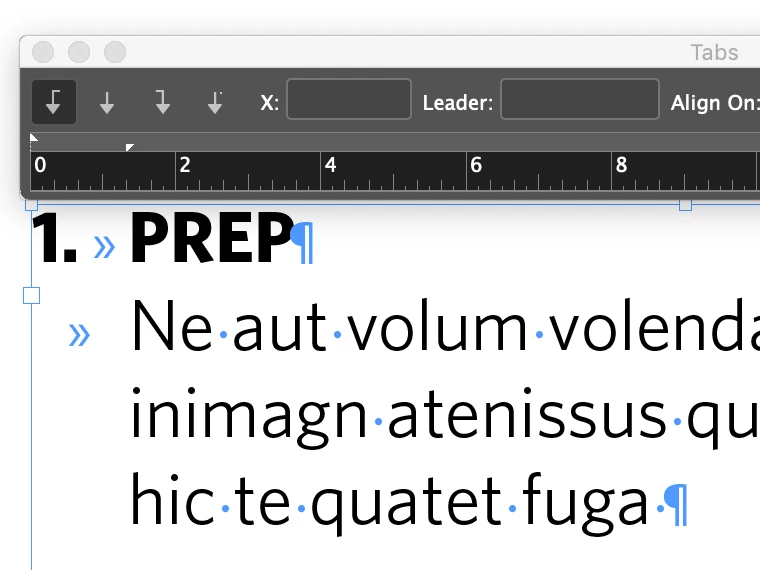

With InDesign (2020 for Mac using Mojave), a hanging indent allows you to tab between the left margin and the indent, as in the screenshot below, without setting up another tab stop at the indent:

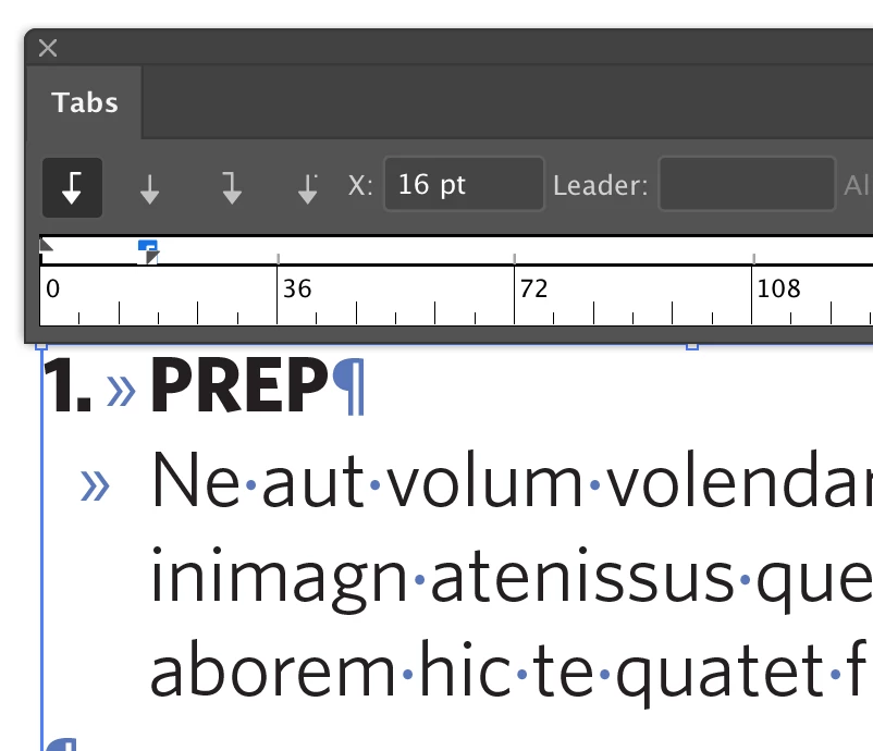

Illustrator (2020 for Mac using Mojave) doesn't behave the same way; you have to set up an additional tab to achieve the same thing:
Please advise, thanks.
Correct answer SJRiegel
For as long as I have been using the two programs, Illustrator has always required the additional tab stop for this, and InDesign has not.
SJRiegelCorrect answer
February 27, 2020
