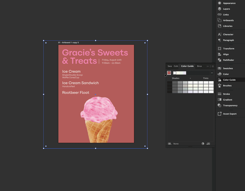

Aug 14, 2026 5:13 PM UTC
I have a similar issue, but it is pulling only Greys as the main color.  Version 30.7
Mac OS Sonoma, M2 Studio

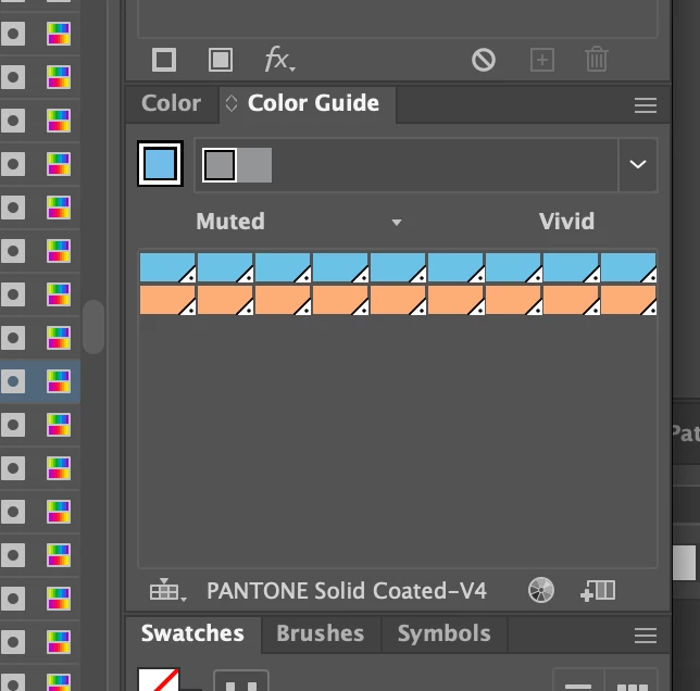

Aug 18, 2026 1:05 PM UTC
Not exactly.  My issue happens when using the Color guide, similar issues not getting the correct color from the color book.  But now, instead of 50% grey, it is a red-brown color.. but still not working at all.

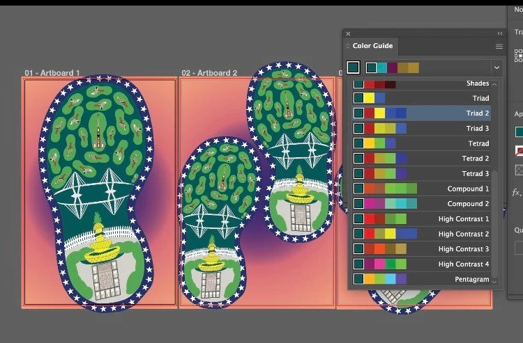

Jul 2, 2026 10:49 PM UTC
I too am encountering this issue. Mac Studio M1 Ultra, Tahoe 26.5.1 & Illustrator 30.6
I have attached an example file that I first encountered the issue in, however like others have said, I am experiencing this issue in every file I open or create in Illustrator.
Workflow: trying to use the tool like normal. As OP described, the top strip updates when selecting a new color but the previews do not.

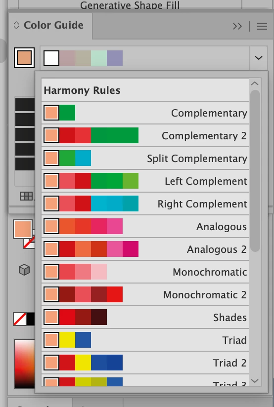

Jul 1, 2026 10:12 AM UTC
Hi, attaching a sample AI file would be pointless as it happens with all files.
The workflow is basic… select any colour in Color Guide and no matter what that colour is the Harmony Rules menu displays the same colours. See the attached.
I’m on Illustrator 30.6, MacOS 26.5

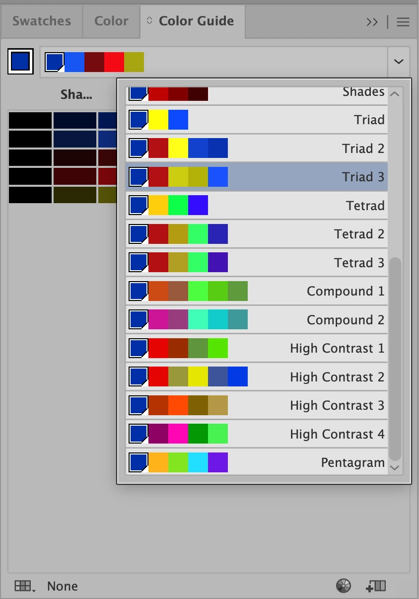

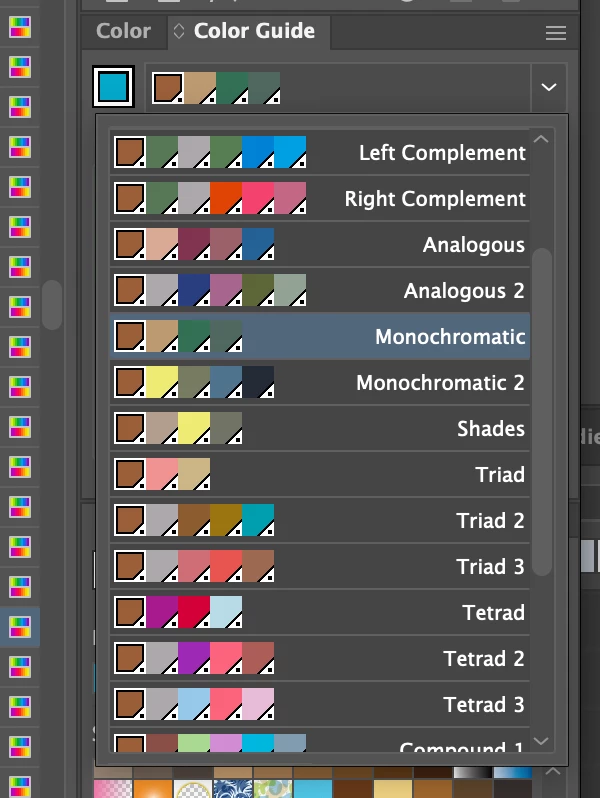

Jun 18, 2026 2:17 AM UTC
I am having an issue as well. Tried all the reboots. Uninstall/reinstall. Rename and reset preferences. Nothing?!?
when selecting a color. The harmony will or display as I’m the drip down menu. Only tints/shades. Doesn’t matter if it’s a new or existing file.
have a second computer. No issues?
below. Note the highlighted swatch yet the actual color harmony will not display in the ‘bright’ colors. Only dimmed/tints/shades. Triad is the selected harmony in this instance.
hoping you can provide some insight. Thanks.

Sherri530
Jun 18, 2026 2:19 AM UTC

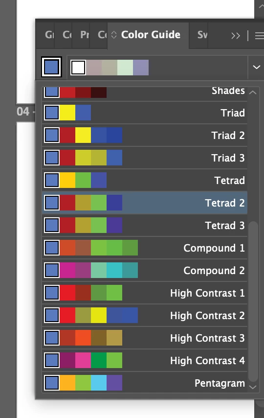

Banner+Factory
Jun 18, 2026 3:11 PM UTC
For what it’s worth, same issue here.
But I notice we seem to have the same set of preview swatches. Looks like we’re all stuck on the default set?
Noting that the drop down preview is accurate, so it’s likely a display setting that got mulched last update?
Happy to hear this isn’t a “me” thing, but eager for it to be resolved.
