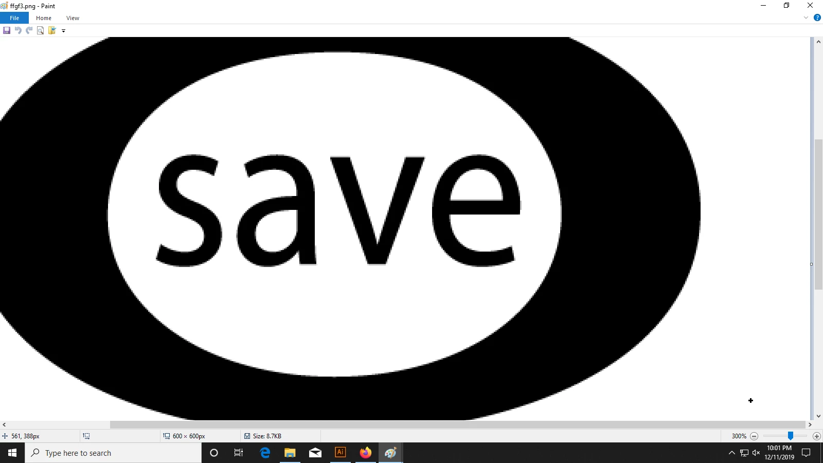

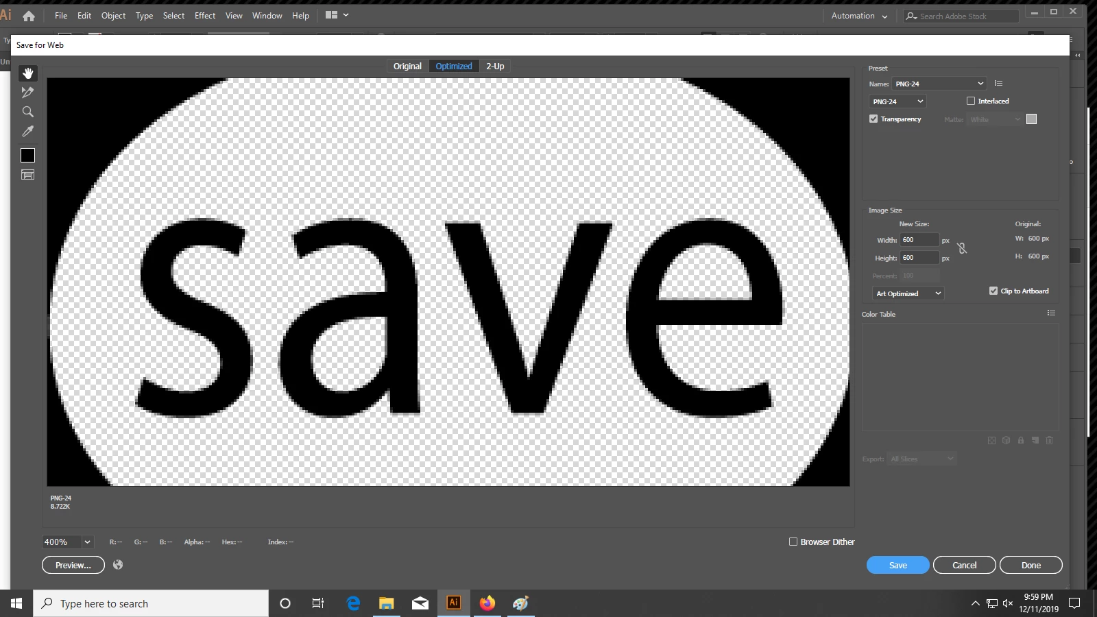

hello, i have alittle problem with illustrator software.when i create a desing with illustrator software ,the desing looks very good.everything perfect.but once i save the desingas as a PNG format and other formatsthe quality of the desing is very low.blurred and pixel is very bad.what is the cause and ho do i fix this problem? plz help

My guess is that you saved the PNG at a low resolution (perhaps 72 ppi?), then made your screenshot at 400%, so pixelization is to be expected. Make the text the size that you want it before saving as PNG, and probably at a higher resolution, say 300ppi. Then view it at 100%.
