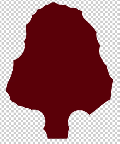

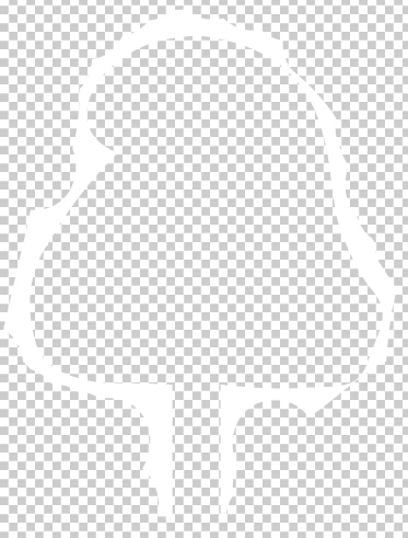

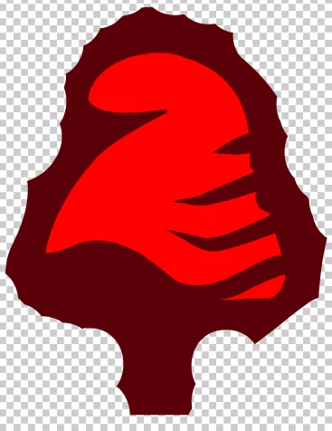

To start I've deleted all of the unnessary layers and then used the eraser to whittle it down to as close as I can get it to where I want without worrying about erasing parts I want to keep. These are the remaining six layers. The black layer above the white doesn't really do anything; the dark bugundy layer on the bottom was black before I changed it. I have no idea what the bottom four layers are doing since toggling their visiblility doesn't change anything that I'm able to see.

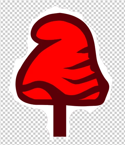

What I'd like to end up with is what's shown below, but without the white outline - transparency where it's now white. In PS I would make a selection of everything white and delete on the relevant layer.
Without the white layer the darker layer is jagged; the white layer above it is what smooths and defines the image.

As far as I can see from your image, Barbara's advice is the best. The "Minus front" action is the easiest and fastest way to achieve your goal. I would only add a small preparation step: decrease the size of the burgundy object a bit (1-2% is enough) to ensure that its edges are strictly inside the white area.

Another possibility. You could select just the white shape and the dark maroon shape. If these objects are grouped, use the Group Selection tool to select them -- other wise ungroup first. In the Pathfinder panel click the Minus Front icon (second icon top row). For this to work, the white object must be on top of the dark maroon object.

You could try and select all and then open the Pathfinder panel and click on "Merge".
THis splits everything in a way that only neighbouring shapes are left. Then you should be able to select the excessive white parts and delete them. You might need to ungroup the result first.
