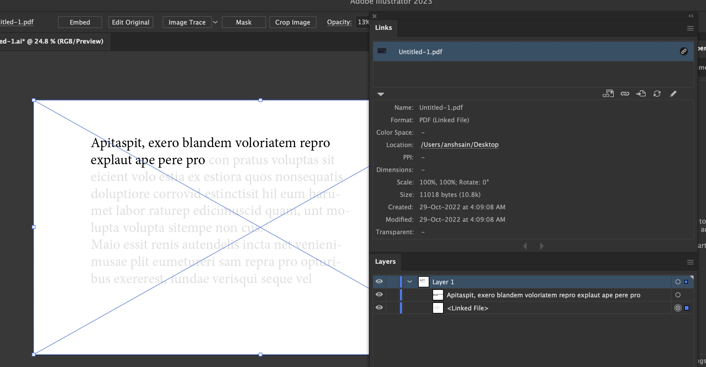

Hi @Kathy23857956s2qv,
We are sorry to hear about that. There is a visual difference when content is built on top of an image/ placed PDF like you are doing, as InDesign uses a different magnification scale than Illustrator. The 100% view in InDesign shows the print output size. In Illustrator, the 100% view is the 1:1 ratio of image to monitor pixels.
However, if you are using the same font properties, it should print the same out of the two applications.
Would you mind confirming if this was working correctly earlier or if this is a new idea/ method that you are trying?
I will be looking forward to your response.
Anshul Saini

Hi @Monika Gause,
Yeah, you are right. I overlooked the part before & after Kathy mentioned "placed image with transparency." Thanks for pointing this out.
I checked on my end, and it works perfectly in Ai 2023.
@Kathy23857956s2qv, please ignore my above reply, and would you mind sharing the InDesign file, exported PDF, and Illustrator file along with the Helvetica World font? We will check on our end and share our observations with you.
Looking forward to the files.
