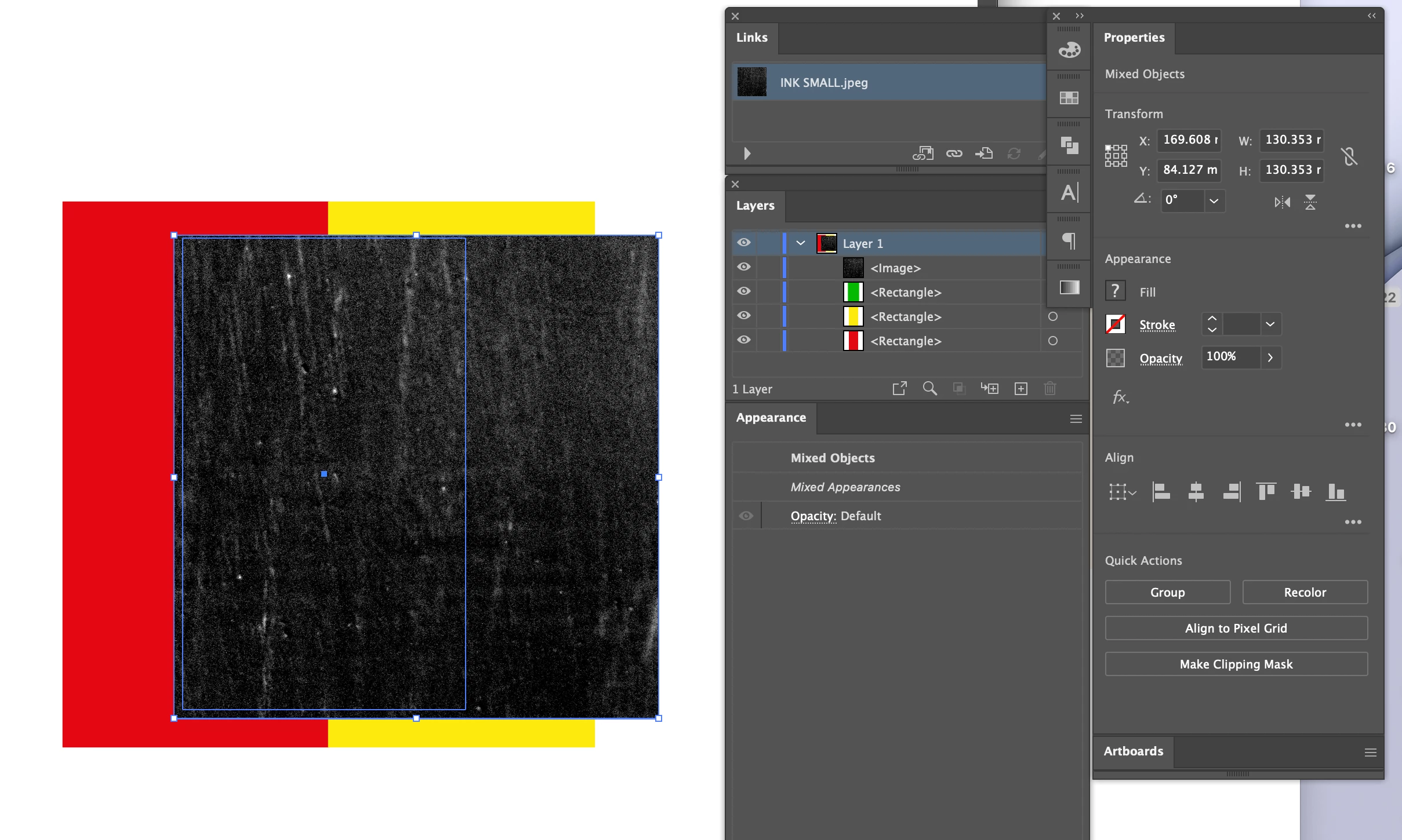

Hi All,
I've inherited a file that features a shape with a bitmap transparent texture. The trouble is I can't work out how it's done, and therefore replicate it for other shapes. 

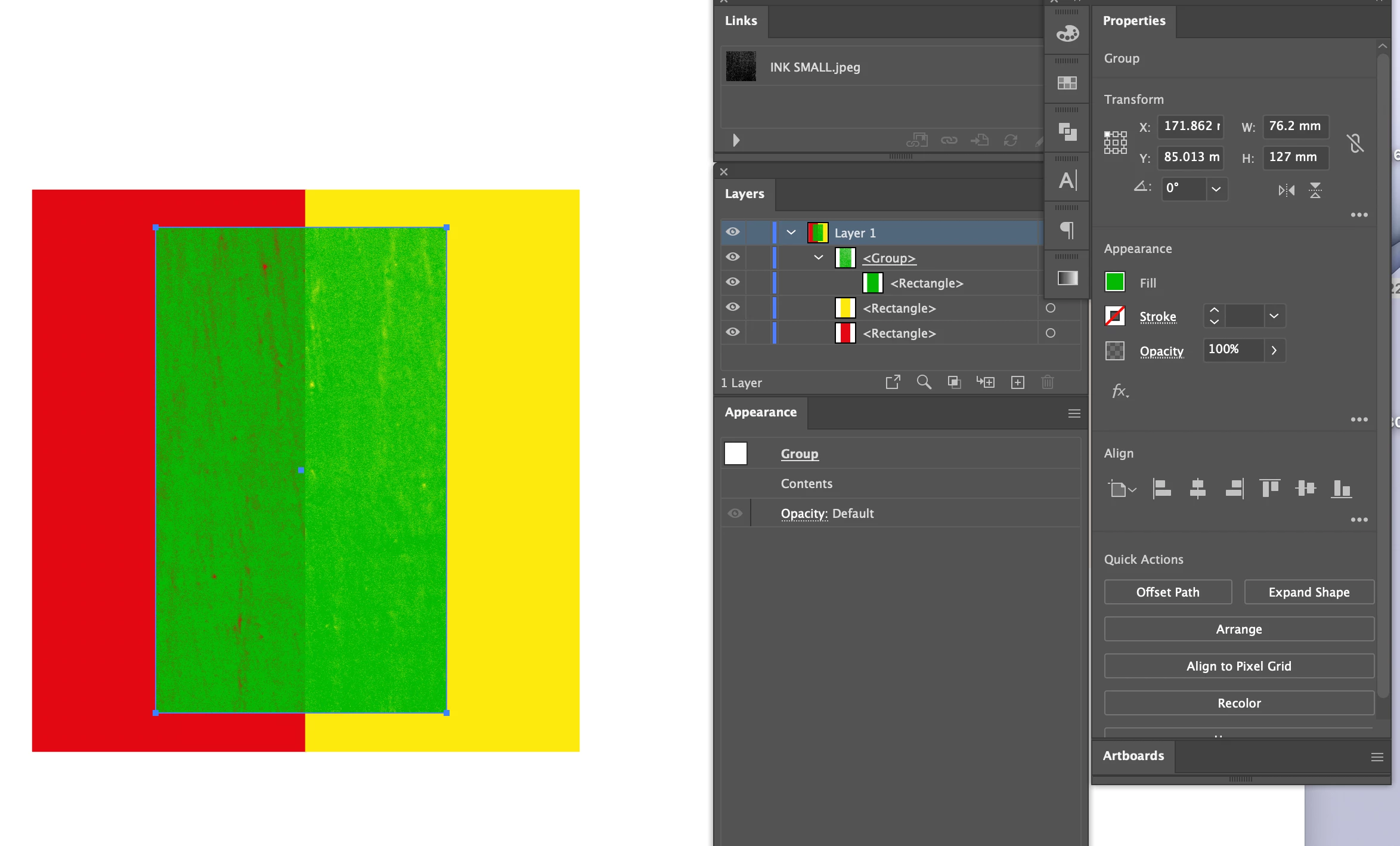

1. Here's the inherited textured shape shape. As you can see, the shape is in a group, but the group is showing as just the green box. There is no clipping mask or effect applied.
2. On 'Ungroup’ the jpg texture is revealed overlaying shape. Regrouping just gives me a group with the green box and the black JPG - it does not replicate the transparent texture of the original.

Correct answer Ton Frederiks
Can you check the Transparency panel for an Opacity Mask?
Ton Frederiks
Ton FrederiksCommunity ExpertCorrect answer
September 4, 2022
aliasrickAuthor
September 4, 2022
Aha! That's it - brilliant!!! I had not idea sucha thing existed. Thanks so much Ton
