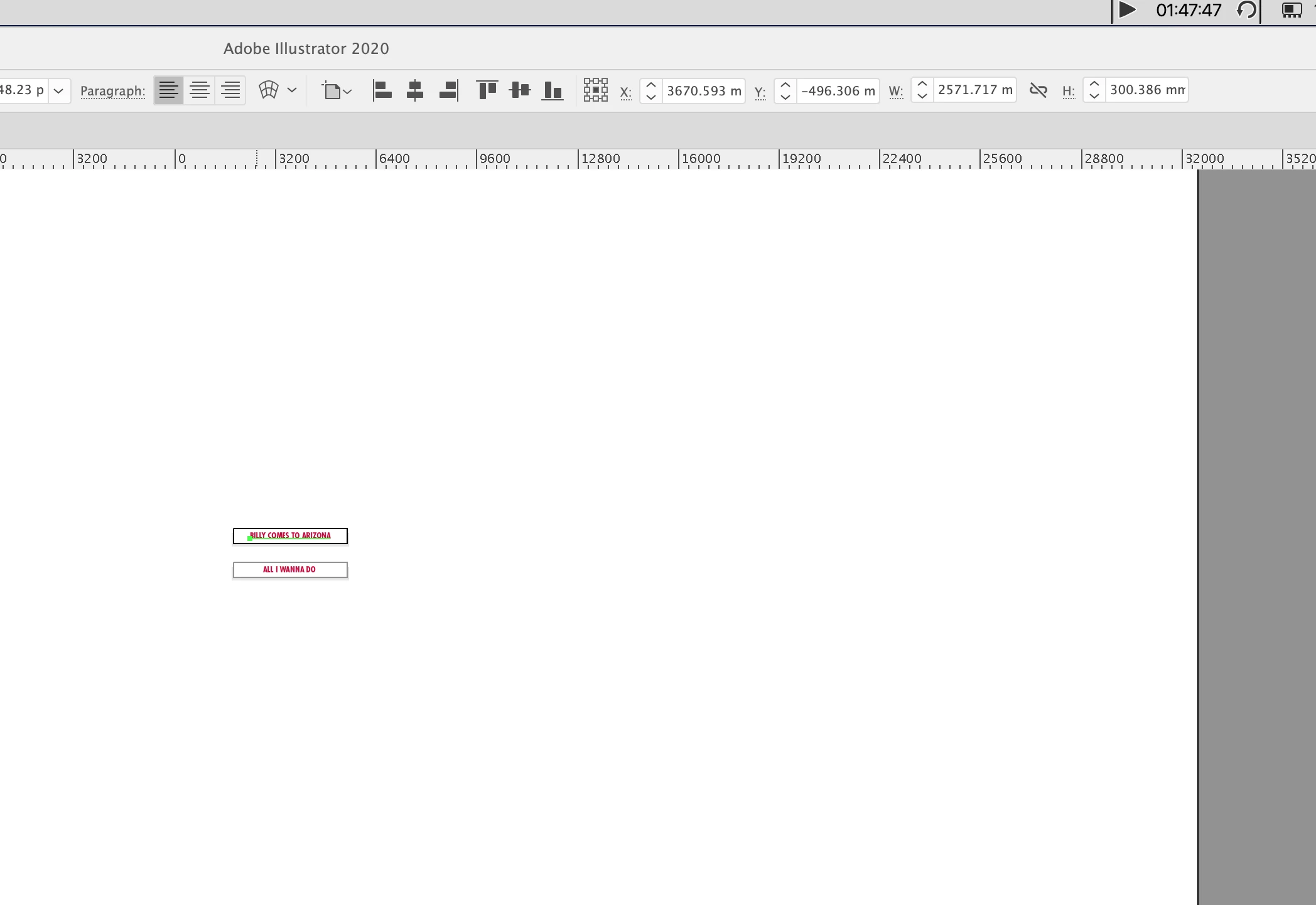

I use illustrator to cut sign graphics so it's linked to a plotter.
I have a file I'm working on that has clearly been scaled. Artboard says it's 3800mm x 400mm but when I print it's 380mm x 40mm. There is nothing to show that it has been scaled.
the only workoround is to create a new file and cut/paste everything in.
I'm sure this is a 'clever' feature meant to help and not result in £££'s worth of wasted material. Any ideas how can I turn this ridiculous feature off?
thanks

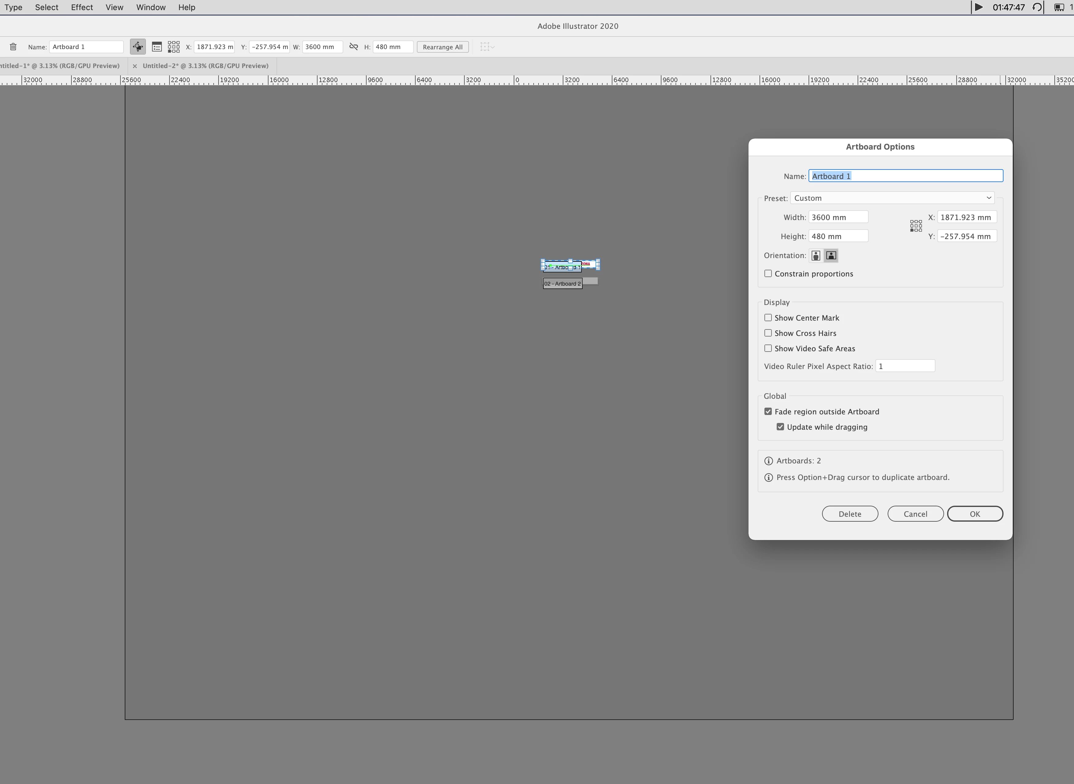

Large canvas files were introduced in 24.2. I
Which version are you using?
June 13, 2024
Hi thanks... this is 24.3. "Large canvas File"... that sounds like a thing that may cause this...

Did you work in a Large Canvas file?
June 13, 2024
My original artboard sizes were 3800 x 400mm so ok to be in 'normal' mode. Maybe somehow it's decided to do a "large canvas" thing. I did try the Adobe "Help phoneline" .... yeah, won't do that again.... over an hour of the chap telling me it's down to how it's viewed on screen, never mentioning "Large Canvas" at all......
