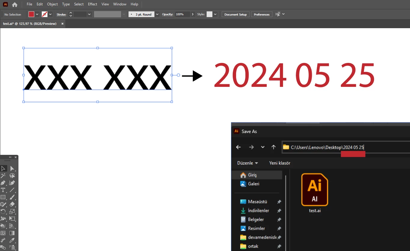

Hello guys. Can i replace "XXX XXX" text with folder name (where i save in test.ai illustrator file).
Is it any jsx for this? I do this all day it will very helpful for me.

Thank you. It works.
But  i need two more detail.
1. I need to write " " (space) for my project. It writes "%20" for spaces. Can i fix that.
2. I need to select text object for that. Is it possible i dont need to to select. Because i have 4 of them for one product. And all of name is XXX XXX XXX XXX.

Under Windows?
The document must be saved. The text frame must be selected.
Note: Do NOT use spaces in folder names - use underscores or minus signs as separators
Try this snippet as JSX:
// select your XXX XXX textframe, then run this script snippet
// Hint: Do NOT use spaces in folder names - use underscores or minus as separator
var aDoc = app.activeDocument;
var nme = aDoc.path.toString().split("/").reverse();
var aSel = aDoc.selection;
if (aSel[0].typename == "TextFrame") {
    aSel[0].contents = nme[0];
Untested. Sent from phone
